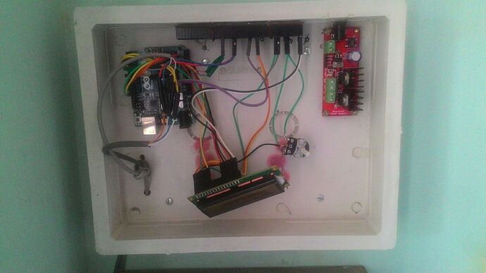

Hello guys,
I'm a newbie into Arduino, and i'm deeply intrested in making a home security system with 4 PIR motion sensors and output on 16, 2 LCD screen.
I used the basic PIR code from arduino to get output on diferent LED's for corresponding PIR's; but the problem is at night, its hard for me to remember which LED is which zone! So i decided to hook it up to an LCD screen.
Im so depressed that my initial attempts with coding were an utter failure; but some how i got a sketch from codekaola.It works fine with one PIR, but i dont know how to modify the sketch to attach 3 more sensors!

First suggestion: modify alertLcd() so that it takes a string as an argument eg alertLCD("All is well"). Get that to work with your existing sketch. This will allow you to send a different message for each sensor later.
Next suggestion: learn about arrays. You will need arrays for each of the parameters such as pirPin, lockLow etc . Modify your sketch so that it uses for example pirPins[0] instead of pirPin.
Finally you can put a for loop just inside your main loop() that iterates over as many pir sensors as you have input pins- each one will have its own index into the arrays.
If you do all this you will have learnt a lot of valuable lessons about programming.
Heres a little hint as to what it might look like
int pirPins[] = {2, 4, 8, 3, 6};
   for (int i=0; i <6; i++){
      if digitalRead(pirPins[i]) {
      // etc etc
