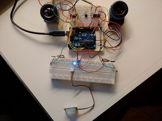

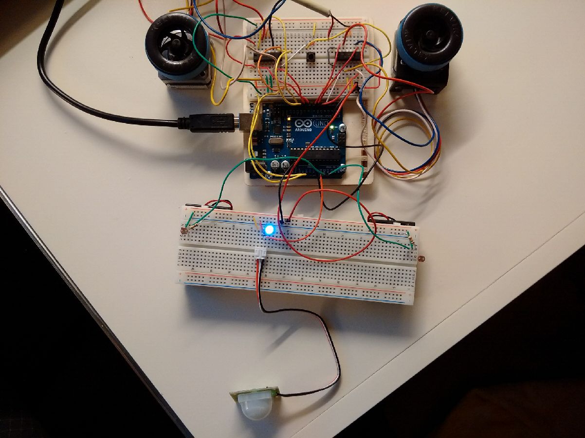

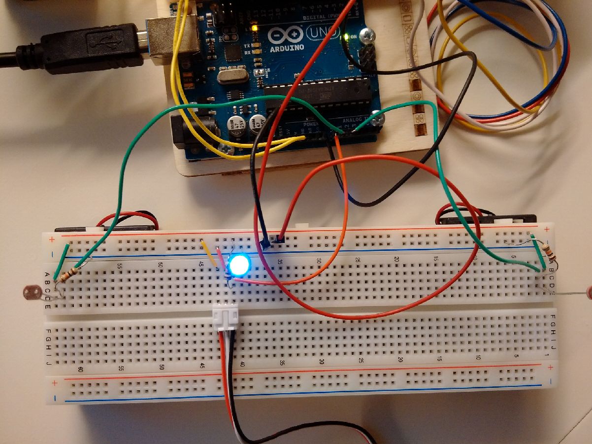

Hello everyone, just got my first PIR and having fun but I cannot figure out why it does not work consistently. I can shake my hand in front of it and will register the movement however, there is a good chance that it will also not see me.
Is there a refresh rate on these that is slow to pick up moving objects?
I have attached my code and pictures of my hardware for reference.

You need 5 seconds or more between detections for reliability or it simply adds the second detection and stays on. The output is a pulse of a few seconds or more.
Weedpharma
First of all does the PIR needs like 5 seconds after power on to work normal. After that it has indeed a pulsed out but also a lock out period after that in which you can't retrigger it. And last, most have a setting for retrigger or non-retrigger mode.
