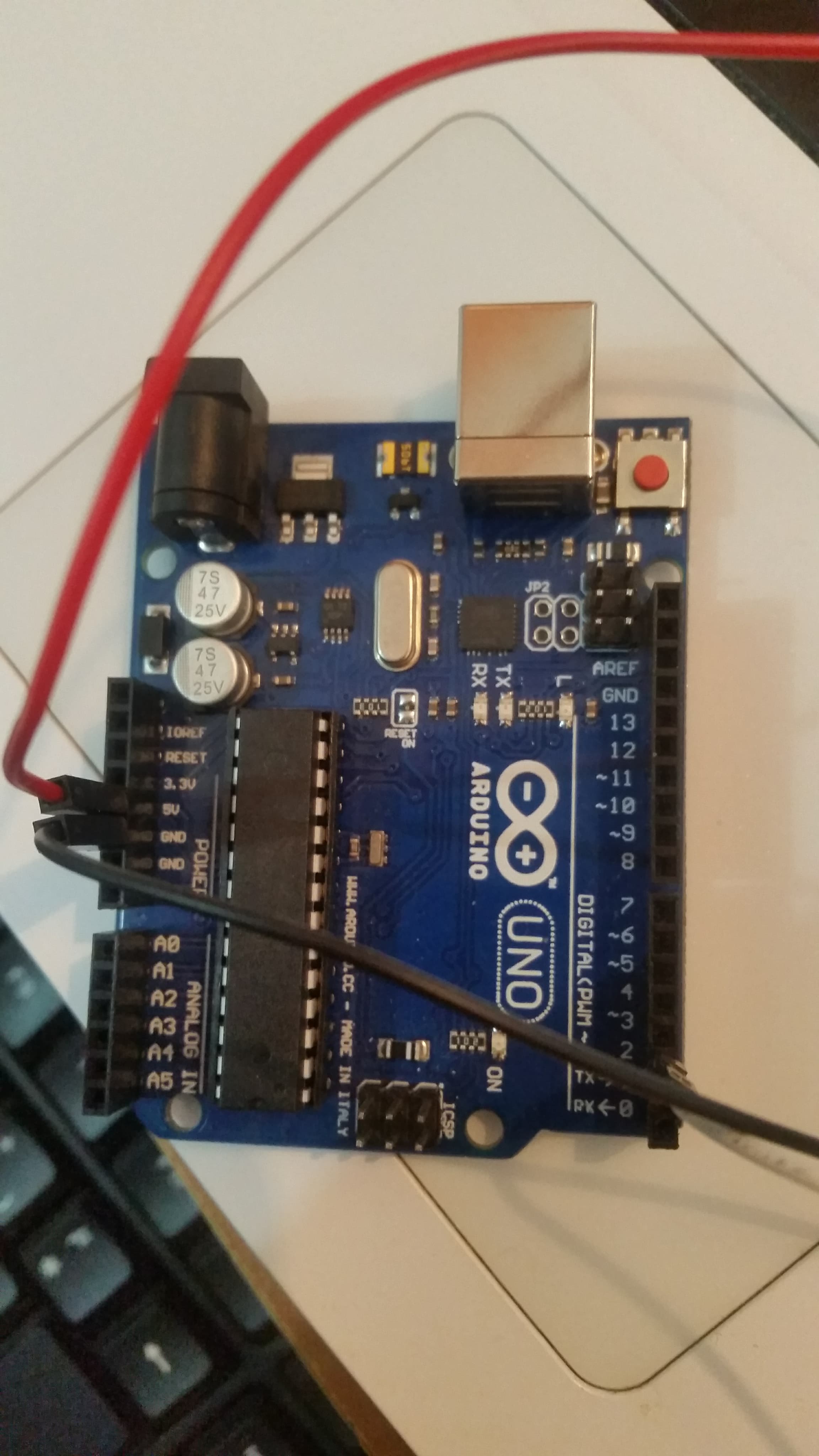

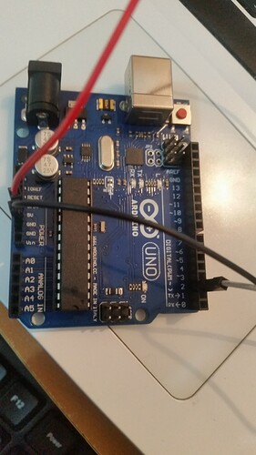

these picture show how i connected the device.
thank you for your help!

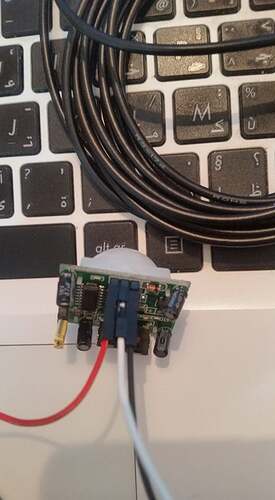

Sorry but they don't do any such thing.
One is an Arduino with a wire in 5V and Gnd. The next is the same thing but with a grey wire coming out of pin 2. And the final one has a PIR sensor with three wires coming from it. The white one appearing for the first time.

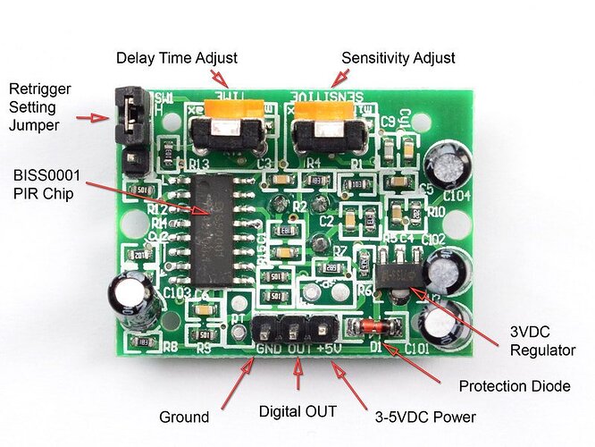

However I can see that you have got power and ground connected to the sensor the wrong way round.

Well I half take that back. The video does indeed show the correct wiring but the Fritzing crap layout has it wrong.

I believe the reason for the part being that way is the PIR module Adafruit sells happens to have the opposite pinout from all the common cheap PIR modules you find everywhere else:
I seem to remember that Fritzing part was made by Adafruit.

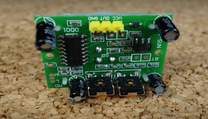

To make things worse, some of the modules (like the one BeastHunter is using) have the pinout marked on the side of the PCB that's covered by the diffuser!
After reading your well detailed comments i did correct the mistake which was inverting GND and VCC wires on the sensor. I have feared destroying it if i have messed with that so i thought to ask first, and i would like to thank you all for the information that you provided.

BeastHunter, from the picture shown for your board it shows that you have not selected either the re-triggering Mode or the non retriggering mode. In the lower left corner you see three pads marked MD L and Hi. If you notice in the adafruit board shown by pert there a jumper provision is made. You may not have blown your PIR sensor.
