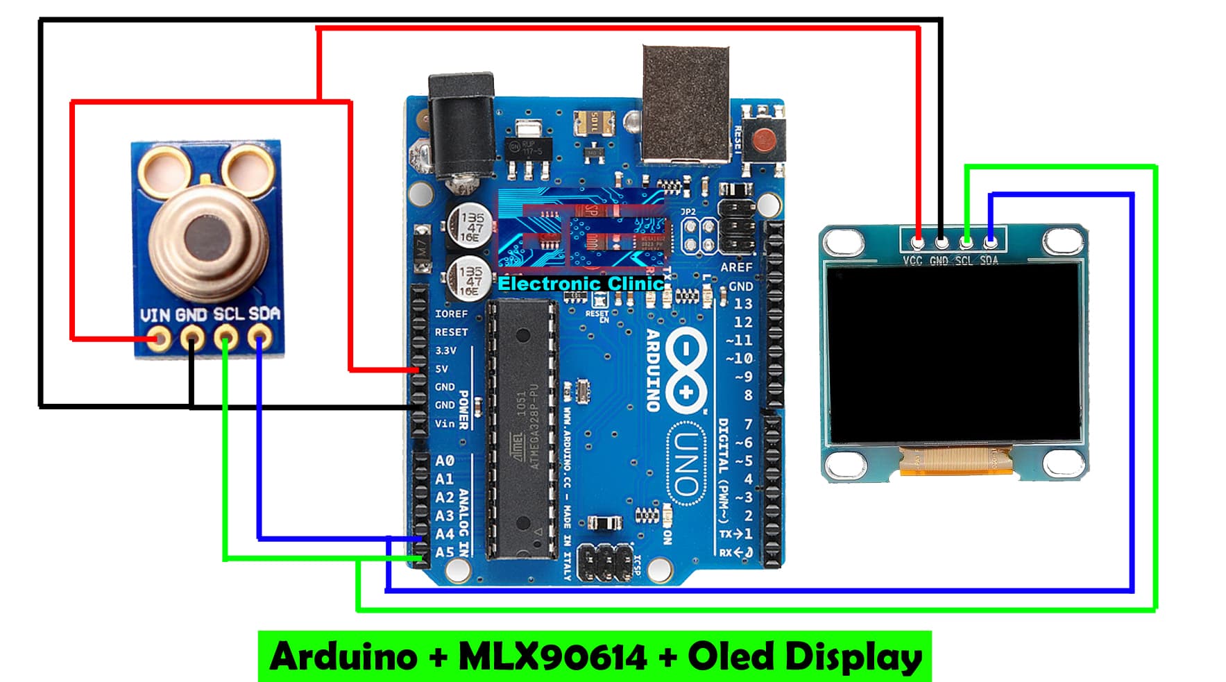

hi, I'm working on a spo2 (max30100) and temp(mlx90614) measuring system using Arduino uno when i connect each sensor individually to the uno i get correct readings from both sensors, but when connected at the same time the spo2 sensor works fine but the mlx90164 temp sensor reads very unusual temperatures like (-231, 879,376.-100,1007 ,....). I'm using an OLED (I2C) display to view the output. This is the code:

You could do for all of us what all of us would have to if you don't and say a bit more:
Are these all I2C devices? With no address conflicts?
Do you have links to the make and model of these sensors you could share?
Could you post the sketches that make each work alone, please?
A schematic, even hand drawn take a picture and post it, actually the easiest and best might help, too - be sure to show all the connections and in particular how power is supplied to everything.
Have you tried leaving off the OLED for the moment, and just using the two sensors and the serial monitor?
And so forth. This should take you no time at all, if you had the schematic already, which you should have. Sometimes putting your case together will help you spot something you've overlooked. Mostly just efficiency, yes googling would be easy but there's so much good stuff on Netflix and all. :wink:
TIA

-yes all are I2C devices with no address conflicts
-max30100 is an RCWL-0530, but the mlx90614 has nothing on it
Untitled
  • yes tried disconnecting the OLED, same thing
  • I also changed the I2C_BUS_SPEED for the max30100 from 400000UL to 100000UL, then the mlx90614 reading is correct but the max30100 is wrong!

One of the devices, forget which one after 45 seconds, has a max clock speed of 100 kHz, so set that and forget about it.
Leave the OLED out of the picture for now, as it can be a separate problem after the two sensors are functioning together.
I see no address conflicts, and though it is not clear, the presence or absence of additional pull-up resistors on the bus shouldn't be a problem.
Except. This article claims the MAC30100 just won't work at all
pull up resistor problem
So, has that sensor all by itself produced plausible results?
I assume you have the 5 volt version of the other sensor.
I see from your wiring diagram that you are powering everything off the 5 volt pin on the UNO. This is an UNO no no… unless you are drawing very little current. So that's something I haven't time for just now, but might be a clue for you or another forum member.
It is advised to have an external 5 volt power supply for all you attached devices. This supply can power the UNO as well, or the UNO can just enjoy the USB power.
That's all I have on this, just some ideas.

  • For your first point: as I mentioned I changed the clock speed of the max30100 from 400 to 100kHz ( as it is the only one that has clock speed in its library), after doing that the mlx906214 started working ok but the max301200 didn't read correctly ( the opposite situation of the original try)
  • As for the address conflict: I ran an I2C address scanner, and there were no conflicts in the addresses.
  • I fixed the problem of the spo2 max30100 sensor from the beginning by removing the resistors as mentioned in the like you sent (spo2 is working fine )
  • As for power I connected the sensors to an external power supply separate from the UNO, but still no luck
  • As for the sketches for each individual sensor, in order for the two sensors to work simultaneously their sketches were altered

update:
after removing the OLED and changing the clock speed to 100000ul
Wire.set clock(100000)
the measurements outputted to the serial monitor are correct on both sensors, so the problem is when connecting the OLED to the Arduino
this is the code after removing the oled
any thoughts ..... ??

These are world wide fora, it is not uncommon to wait hours for response. A bump pleading for help might only be justified after a day or so.
It appears that the two working sketches, thanks for posting them, use two different oled libraries.
So we know one sensor gets along with library A, and the other gets along with library B.
You picked one for the combined sketch. As you must.
I don't see
in #9. But I think a solution, maybe, but progress no matter what, would be to restructure your code so that
  • get one sensor's data
  • get the other sensor's data
and then
  • format and present the data on the OLED.
The OLED code should not be interleaved with the other uses of the I2C bus.
At the very least, move the I2C stuff so it is not interleaving. You could go further, which would might be a good idea in any case:
By isolating the OLED functionality, you have an easy way to try both libraries. Write your own functions, and put the gory details of dealing with a display in those.
So you might have three versions of a few functions. One set for testing, which would put the data on the serial monitor. And one set each for how the two libraries are used. Differences may well only amount to how the display object is instantiated.
Start with the least functionality you can get away with, until you find that one, or the other or both display libraries are happy.
This is what I woud do, as I have no idea why what you did failed to simply work. Ppl with Eagle eyes may spot something dumb in your combined code yet.
