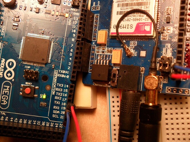

Hi
I am running this GPRS Shield V1.0 shield http://www.seeedstudio.com/wiki/GPRS_Shield_V1.0 with a MEGA2560.
The library I use is GitHub - MarcoMartines/GSM-GPRS-GPS-Shield: GSM/GPRS & GPS Shield Library for modules using SIM900/SIM908 (Install Notes:
Download current release: Generic Version/current) and it has been set up for the Mega board. I am using Hardware serial with pin DO and D1 on the shield and pins 18 & 19 on the Mega.
When I run the GSM_GPRSLibrary_AT sketch I get this:

ERROR: SIM900 doesn't answer. Check power and serial pins in GSM.cpp
status=IDLE
I cannot find a solution to the communication issue. Has anyone has had this problem and how can it be fixed?.
Thank you :sweat_smile:
Regards
Luke

Use the hardware Serial ports instead, i.e. Serial2 or Serial3
The answer that I gave you before did not work ?
myself, I dont use library,
Library are changing too many parameters that you dont particularly understand , especially Github
i only use commades Hays, I spend a lot of time to understand them,
at the beginning:

If you are using Arduino Mega 2560, follow these steps.
[1] How to switch between Arduino Mega and Arduino Uno?
Open GSM.h and comment-decomment the appropriate lines like below
e.g. for Arduino Mega
//#define UNO
#define MEGA
If you use Arduino Uno comment the line in HWSerial.h or decomment if
#define MEGA
Save and compile
[2] How to switch between the old shield (that uses 4 and 5 pins for
SoftwareSerial and the new (that used 2 and 3 pins)?
Open GSM.cpp and comment-decomment the appropriate lines like below
e.g. for the new one
//#define GSM_TXPIN 4
//#define GSM_RXPIN 5
#define GSM_TXPIN 2
#define GSM_RXPIN 3
Save and compile
Connect the RX pin of your sim module to pin 18 of your arduino mega and the TX pin to pin 19 of the arduino mega. This is because the library uses Hardware serial for mega. Connect VIO pin of your sim module to IOREF pin of your arduino mega and the connect the GND of your sim module to GND of your arduino mega. That's all.
