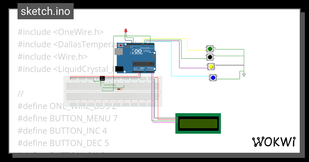

Please, I have a problem with the lamp turning on
30.00 is only default when BUTTON_MENU is pressed
Enter the temperature adjustment menu. Set is the target temperature
and currentTemp is the water temperature given by the ds18 sensor
By pressing the BUTTON_OK button, the set target temperature is confirmed and the comparison between
setTemp and currentTemp
The lamp represents the water heater
Even by connecting it to the GND Arduino, the same problem remains
If 30c is the "ambient" temperature... when your sketch checks if the water is "too high" or "too low", rather than IF > 30 ... IF < 30, use IF 32 ... IF < 28... that way your ambient temperature can be +/-2 degrees without turning the lamp on. Does that sound good?

My result with the sketch edit: temperature reading without the lamp on.
The GND symbol is ground. There is no need to explicitly connect a GND symbol to the Arduino GND.
Removing the GND symbol at the buttons makes the buttons not work.

The circuit will damage the Arduino, unless you add a resistor in series with the LED.
The problem of turning on the light after pressing the ok button has been resolved
Now the comparison is not done because the temperature exceeded the required temperature and the lamp is still on
I know this, thank you, but this emulator only has one resistor with a value of 1k ohm
Actually I use resistors
This is a technical forum. Please post the correct circuit, rather than an idiot diagram.
That is why we ask for real schematics.
See post #28.
The problem is that it doesn't compare
You can check here
If done correctly, it does check. See my post #23
