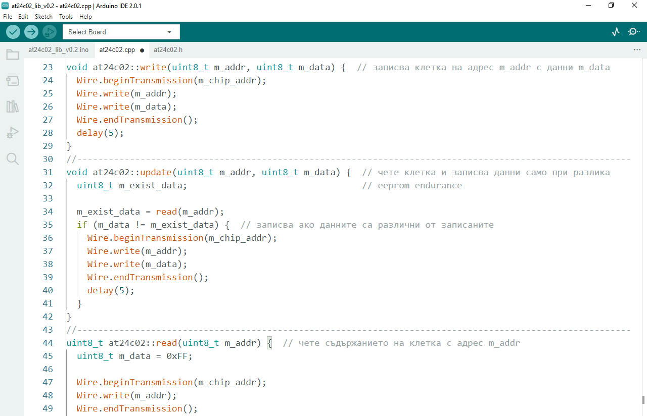

If I understand your problem correctly, there is a solution. The problem is about e.g. the below line, correct?
  m_chip_addr = _i2c_addr;                                  // I2C адрес на EEPROM
which changes to
The relevant links copied from topic Clang setup; where is .clang-format, post #2,
  1. The configuration used by the IDE: https://raw.githubusercontent.com/arduino/tooling-project-assets/main/other/clang-format-configuration/.clang-format
  2. Link to the documentation: Clang-Format Style Options — Clang 14.0.0 documentation
If you haven't created a .clang-format file yet, that is the first step. Use link (1) and copy it; paste it in a decent editor and save it in C:\Users\yourUsername\.arduinoIDE with the name .clang-format (no extensions, literaly like that). This will be the global configuration file for the autoformater.
In the file, find the line SpacesBeforeTrailingComments: 2 and change the 2 to -1. Save the file.
Unfortunately the value -1 is undocumented in link (2) for the above option. So the behaviour might change in the future; there are however a few numeric settings that allow -1 to indicate that something should not change and that is what I based the solution on.
In the IDE, apply the autoformat to your sketch or file. Note that you can make changes to the clang-format file on the fly; no need to open/close the IDE.

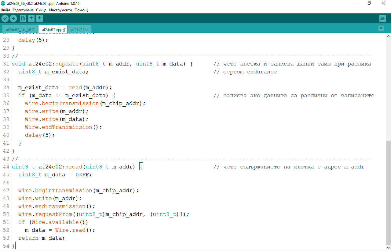

v1.8.19 before Auto Format:

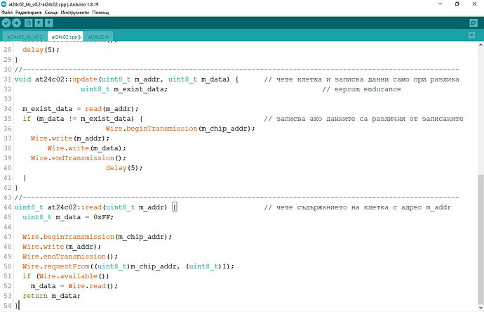

v1.8.19 after Auto Format:

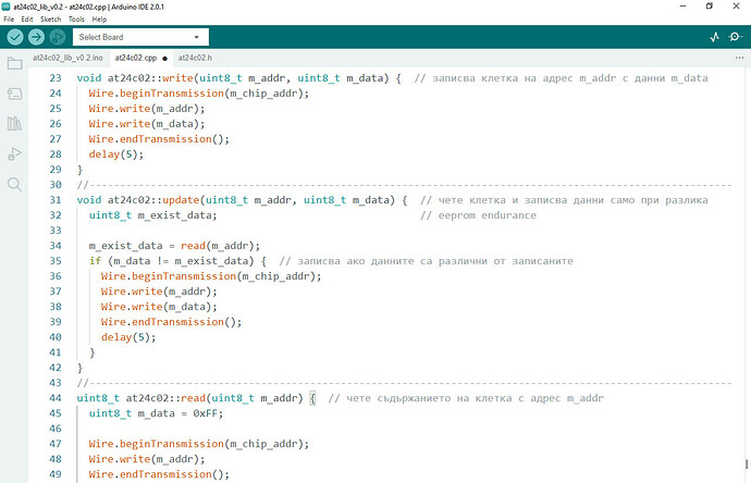

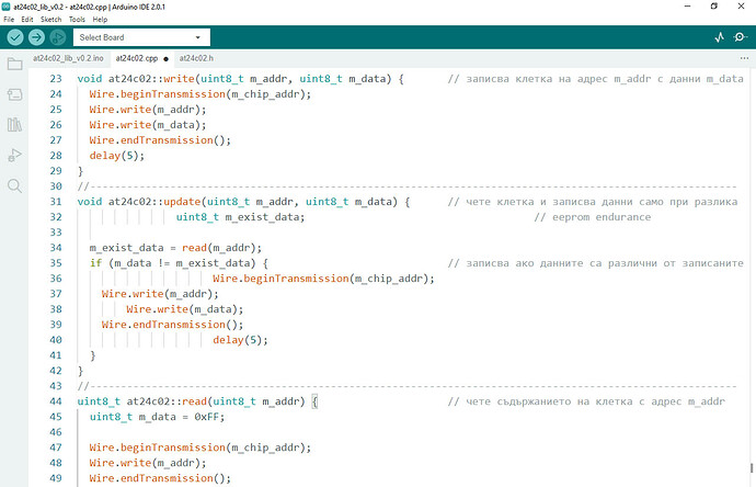

v2.0.1 before Auto Format:
v2.0.1 after Auto Format:
