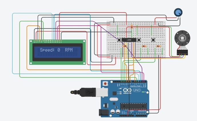

PLS HELP : error in the project of Control speed of stepper motor with buttons
Hi I'm using an Arduino UNO try to do a speed controller 28byj-48 5V connected with motor driver.The speed is control by three buttons with 3 different speed which is 30,60 and 90 rpm respectively. The rpm value will shown in LCD when the button pressed. However, the stepper motor doesn't work when I pressed the button. I do the simulation in Tinkercad, can someone help me solve the problem?TT

I'm sorry, but I'm unclear on what problem you're having with the 1.x IDE (that being the category you posted in). Could you please expand upon that?
Do not use the Arduino TX pin 1.
EDIT: That code looks fresh outta chatGPT.
If INPUT_PULLUP then NOT pressed is HIGH, button pressed will be LOW.
  • Pin 11 is used in both . . .
  • BTW in real life, do not use Arduino to power motors.
Can the BYJ-48 do 90 RPM?
Maybe you should be using a DC motor.
Your sketch (also) confused speed with RPM. RPM you can set and run. Speed you must measure.

Max speed of 28BYJ-48 without acceleration control is about 12 ~14 RPM.
