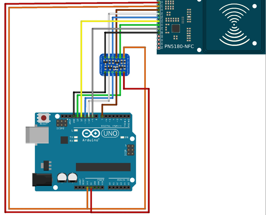

Hello,
I'm new to Arduino and fairly clueless to this world in general.
I'm trying to get ATrappmann's PN5180 github resource to work. While the code compiles, loads, and appears to run correctly, I've been unable to get the hardware to recognize any ISO 15693 cards. I've copied the coding, wiring, and hardware exactly (I think). I'm unsure what level shifter is being used in the github wiring but I'm using a ‎I2C-LOGIC-MD-5PC-SCZW (Amazon link here).
I've confirmed continuity on all the solder joints and have tried to check voltage. I read 5 and/or 3.3 at various connections but have no idea what voltage should be reading where or when.
I'm running the FeliCa example file.
Here is the wiring diagram:
Any ideas on how to effectively start troubleshooting this? Aside from importing the entire zip file, is there something else that needs to be set up to allow the programs to run correctly?
Any input greatly appreciated.

Is the logic translator board the right way around?
HV side goes to the UNO
Thank you for confirming, I was unsure because I couldn't read the labels in the diagram provided by github.
Yes, I had the level shifter oriented with the "orange side" running to the PN5180.
There is no orange side on the product in the amazon link you provided.
Is the "orange" side the HV side?
Sorry, I meant the orange power supply wire, which is the LV side.
Then it's correct.

As it happens, I'm playing with a setup just like this one, and I have got it working, though I'm having troubles with it too.
I'm skeptical about the level shifter you're using. It says " I2C Logic Level Converter" and this isn't I2C. It does look like the one in Trappmann's picture, but what will it actually do? I'm using something quite different, a logic chip which I'm powering off 3.3V, not because I love it but because it's what I have. Are you sure that all the wiring is correct?
My problem is that either I have a defective unit, or the software has a bug, which seems unlikely since it's fairly mature code. What it does is to work well if you move a card in and out swiftly and smoothly, but if you try to edge the card in slowly, to get an idea of when it goes from "seen" to "not seen", the system locks up, and I have to reset the Arduino to get it going again. If there's anyone out there who's familiar with this product, I could use some help too! Actually I'm more interested in the shorter-range tags, using ISO 14443, which requires a different sketch, a modification of Trappmannn's work by Dirk Carstensen. Both programs work, but they also fail in just the same way.
If you bought the kit which consists of the blue PC board with the electronics on it, as shown by Trappmann, and two tags in the form of a card and a key fob, are you aware that the fob is ISO 14443 and the card is ISO 15693? Also, I haven't tried the sketch you're using. To operate the system in ISO 15693 mode, I'm using PM5180-library from the Examples folder. You might give that a try.

Regarding the level shifter, I'm at a loss for what I'm supposed to be using. With my original set up, I was using a TXS0108E but was unsure of how to wire up the OE pin and had also received some feedback on this forum that it may not be reliable for this application. That's why I switched to my current level shifter, no idea if it's appropriate or not, was just trying to copy Trappmann's. In the video mentioned above, a different type of level shifter is used but I'm unsure of what model its.
Based on your advice, I used the PM5180 example and was successful! The BAUD rate was different than other example but I was able to have the serial monitor recognize two different ISO 15693 cards. I did however have a similar issue to you in that the system locks up after looping the commands a few times and requires a hard reset to start working again. I'll try to insert a delay later this evening to see if that helps - again, I have no idea what I'm doing.
My end goal is to identify and store a 16 digit numeric code tied to the ISO card as well as turn an LED from green to red and back with each swipe. This will be used to check tools in and out of a workstation while retaining identification of the user that performed the check.
Will update based on my results. I'm now suspecting my initial setup using an Arduino nano and the TXS0108E may have been working all along.
I added a 1 second delay after each "no card detected" loop which seemed to keep it from locking up and also made it easier to monitor card detections.
