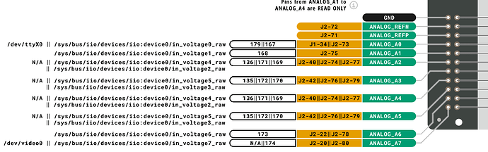

I am struggling with the DAC on the Portenta H7, which I have placed on a breakout board. The goal of my project is to produce a sinewave with a stepwise growing offset, but so far I still work on smaller problems:
- The code below should just give me an output of 10mV for 1 second, then 20mV for 1 second and so on. If I specify A6 as output pin, it works more or less, but the voltage only goes up to 2.2V and then stops there. If I define A7 as output pin, I get continuously 3.3V and no steps at all. For pin A5 or A0, the red led starts flashing during the upload... Why?

According to the documentation, pin A0, A5-A7 should all work, right?
