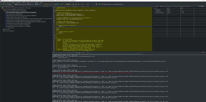

To All:
I've been able to get some semblace of a debugger going under eclipse - screen shot attached - maybe I can find the actual root cause of the difficulty running this demo in a repeatable fashion.
Regards,
John W.
