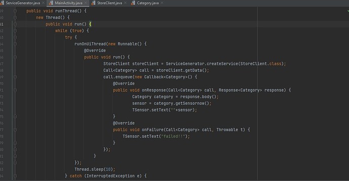

Wifi Data exchange between Portenta H7 and an my own Android app developed using Android Studio
Hey everyone, A few years back, I worked on an IoT project that involved data exchange over WIFI using the ESP8266 and an app I built in Android Studio. Now, I'm looking to transition to the Portenta H7, but I'm not sure how to adapt the project for that. Any guidance on how to rebuild the project would be greatly appreciated. Thanks!
Here is my code:

Dear Sonofcy, Thanks for the response. As you know, the ESP8266WiFi.h and ESP8266WebServer.h libraries are specifically for the ESP8266, so they won't compile on the Portenta H7 board. My main question is, which library should I use for the Portenta H7? I found a demo example for blinking an RGB LED on the Portenta using the web server, and it works great on my board. However, I'm not sure how to modify it to exchange data with a mobile app created in Android Studio. Thanks again.

I really need you to answer post #4
Based on the datasheet, the Wifi module on portenta H7 interacts with M4 core. Hence, I use it for this aim.
You have found the equivalent for running your board as a WiFi Access Point. The ESP8266 hosted a WebServer, i.e. an HTTP server; whereas this is running a WiFiServer, which means no specific protocol support at all. It just reads and writes bytes, as reflected in the client.read and client.print calls.
But HTTP is simple enough for simple stuff. Your original handles a single path to return JSON. In lieu of finding an equivalent HTTP server class, manually performing HTTP would look like

In android studio side, I have four Java files as below:
first I read the IP from serial in Arduino and updated the IP address in “ServiceGenerator” file to http://192.168.3.1/
public class ServiceGenerator {
    public static final String API_BASE_URL = "http://192.168.3.1/";
    private static OkHttpClient httpClient = new OkHttpClient.Builder().build();
    private static Retrofit.Builder builder = new Retrofit.Builder().baseUrl(API_BASE_URL).addConverterFactory(GsonConverterFactory.create());
    public static <S> S createService(Class<S> serviceClass){
        Retrofit retrofit = builder.client(httpClient).build();
        return retrofit.create(serviceClass);
In “StoreClient” file, I send “sensorVal” request to Arduino.
public interface StoreClient {
    @GET("sensorVal")
    Call<Category> getData();
Based on the Arduino code, whenever “sensorVal” is requested, then "sensornow" must be sent from Arduino to android studio in JSON format and will be received in “Category” file.
public class Category {
    @SerializedName("sensornow")
    @Expose
    private Integer sensornow;
    public Integer getSensornow() {
        return sensornow;
In the mainActivity.java the received "sensornow" is then displayed in a textview named TSensor. If no response received, the textview is set to "failed!!".
So, what is displayed in android app, is always “failed”. Hence, it seems there is a problem in requesting and responding.

Thank you. The typo error corrected. Still failed to receive “sensornow”.
Calling from a browser on the same WiFi, does http://192.168.3.1/sensorVal work?
Yes it works. when http://192.168.3.1/sensorVal pressed, “sensornow” value (100) is displayed on the browser. It seems the problem is on the android side.
Does the Arduino print "new client" and the request-line and headers when called by Android? (As noted in the comment, the headers are ignored; although there does have to be a blank line to end the request.)
Huh, they two names are almost-anagrams
arduino
arddino
Thank you, this is the serial in android case:
And in browser case:
In android case, only when the android is connected to the AP, the program detects a new client but seems the request is not received at all.
Just don't be surprised if you see “rpmVal“ in Serial monitor screenshot. I changed “sensorVal” to “rpmVal” as well as “sensornow” to “rpmnow” in both Arduino and Android codes. Sorry for the inconvenience.
You can see a request is received: GET / and the HTTP version. The hand-crafted web server returns 404 for everything except a single URL-path; which is now /rpmVal. Of course, you can modify the code to support more.
Should the Android program be requesting the / path? If so, what does it expect in return? You can try returning 200 OK with an empty body, just like with the 404.
One other difference is that, as with most Arduino web server examples, the connection is forcibly closed after every response. Clients should be able to handle this, but maybe the underlying Java library doesn't like it. (ESP8266WebServer only handled one client at a time, so maybe it did not bother.) To test whether it makes any difference, comment out two lines

Now the client has to disconnect. A browser will tend to hold this open for several seconds in case there is another request. During that time, nothing else can connect -- which might be fine in your case.
Changing the program to return a 200 OK with an empty body didn’t make any difference. The output on the Android side remained the same. The two lines you said have been commented out. In this scenario, the Android app behaves the same, but the web server in the browser is in a worse situation (it didn’t receive the request).
What did you try, exactly? In the mean time, could try always returning a payload, even if you don't ask for it specifically.
        String body = R"({"rpmnow":100})";  //TODO replace with actual JSON string
        client.println("HTTP/1.1 200 OK");
        client.println("Content-Type: application/json");
        client.print("Content-Length: "); client.println(body.length());
        client.println("Connection: close");
        client.println();  // blank line ends response headers
        client.print(body);
        delay(1);
Can then add different bodys for specific requests. Also restored the one-response-per-connection. It would help to know what's expected with GET / on the Android side.
If you still have that ESP8266, can insert a proxy server in the middle that will dump the entire conversation between it and the Android.
First of all, sorry for my lack of knowledge on such sophisticated terms related to web servers, HTTP, and so on.
In my last try, I might not have fully understood. What do you mean by an empty body? Are you suggesting defining the body as body = R"({})";?
How do I add a proxy server in the middle of the ESP8266 program? Could you clarify that a bit more?
