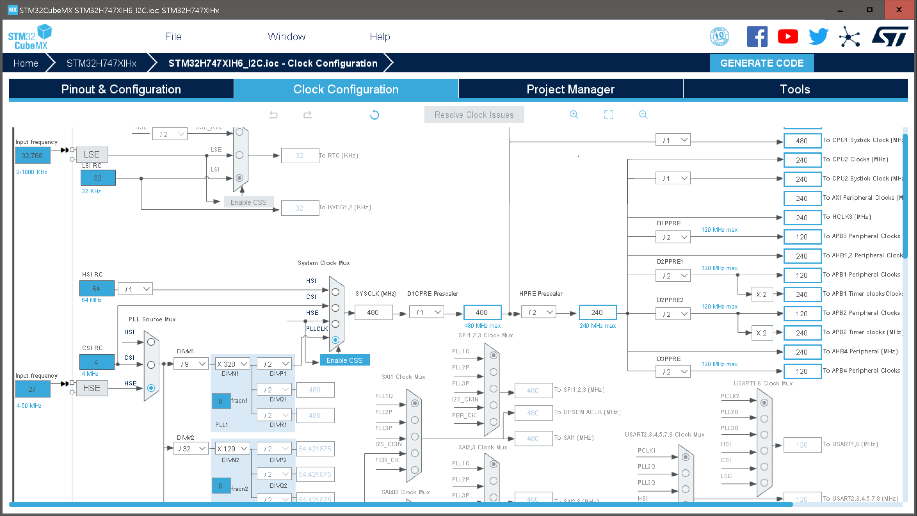

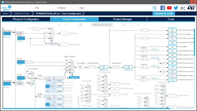

Delicate question: There are some HW issues to bear in mind:
there is an external clock oscillator (you need set to use "bypass" in MCU), 27 MHz, not 8 MHz as on many other boards. If your XTAL frequency is "assumed" wrong, the MCU core clock is wrong.
Also: for the XTAL to work - there is an enable signal OSCEN (PH1_OSCOUT). So, the MCU runs first on internal HSI clock. And this PH1_OSCOUT must be configured as GPIO output and driven by MCU in order to enable the external HSE, before it can change from HSI to HSE. (Usually, this PH1_OSCOUT is left open when "bypass" and external clock is used. But here it must be a driven output).
I could imagine, your system runs still on HSI clock - which is 64 MHz and does not use any PLL. The PLLs can be used only on HSE. And the clock protection unit MCU (CSS) might see that external clock is missing and falls back to HSI. So, I would check first if PH1_OSCOUT is configured and driven to enable external clock generator.
When this enable signal is there, the 27 MHz running (nothing to see), you can change to HSE and PLLCLK. Now, when you play with the PLL config - you would see an effect (different clock speed).
A good help to understand and to play with clock config is to create a project in STM32CubeMX.
Here my clock config I use:
system_clock_override.c (11.2 KB)
I don't have a Portenta but I do have this directly from ST. It's based on the same STM32H7 MCU. I mostly write baremetal code (bypassing ST's own HAL)
Thank you @tjaekel
When you say to enable OSCEN signal, it only consists of setting PH_1 to an output and set it to high level, right?
I have tried your system_clock_override file but did not managed to have a working setup. It seems that one method fail and it returns before the end.
