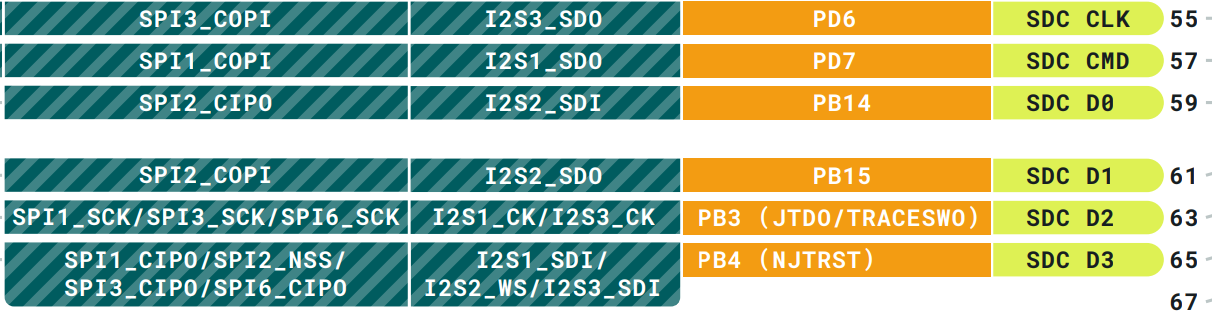

Portenta H7: Want to use STM32H747XI's SPI3
I believe I can access STM32H747XI's SPI3 via high density connector(PB_4, PD_6, PB_3).
So I wrote this code:
#include "SPI.h"
arduino::MbedSPI spi(PB_4, PD_6, PB_3); // SPI3 got error why?
    spi.begin();
However I got runtime error(red led is blinking) when spi.begin() was run (confirmed using ThreadDebug.h).
It works fine with other SPIs, e.g. SPI5 (PJ_11, PJ_10, PH_6)
How do I use SPI3(PC_11, PC_12, PC_10)?

But the signals you want to use are already in use:
PC10 = SDC1_D2
PC11 = SDC1_D3
PC12 = SDC1_CK
It seems to conflict with SD card. Even the Hardfault_Handler called is "strange": you might drive for sure against SD card or you would apply signals to SD card (and get an unexpected response from it).

The pins I want to use are PB_4, PD_6, and PB_3 SPI3.
These also conflict with SDCard, but SDCard has Pin setting in .arduino15/packages/arduino/hardware/mbed_portenta/3.1.1/libraries/Portenta_SDCARD/src/BSP.c, so and I think it is in a FREE state without this.

SPI3 with these signal could actually work - if SD card is not used/not initialized. I do not know if mbed/Arduino code checks the pin mapping and "prohibits" to use pins already associated with other functions:
SPI2 PB4 = SDC2_D3
SPI2 PD6 = SDC2_CK
SPI2 PB3 = SDC2_D2

I found a solution.
Actual pin definitions are in PeripheralPins.c. For example, PB_3_ALT0 is defined as GPIO_AF6_SPI3 in this line.
I can use SPI3 by using PB_4_ALT0, PD_6, PB_3_ALT0 pins
So full code is:
#include <SPI.h>
MbedSPI spi(PB_4_ALT0, PD_6, PB_3_ALT0);
    spi.begin();

It matches with my pin mapping: PB4 = MISO, PD6 = MOSI, PB3 = SCLK (PA15 or PA4 would be NSS for HW controlled NSS).
Where to you grab the signals (on breakout board)? It should be spread over different silk screen pins. Where to find all these signals?
Anyway - well done.
(but why Arduino does call it PB_3_ALT0 when it is actually AF6 in datasheet? Oh men, this board and esp. Arduino SW drives me crazy - found another issue with MCU XTAL and core clock...).
I used SD Card's pins(D2:PB_3_ALT0, D3:PB_4_ALT0, CLK:PD_6) on breakout board.
