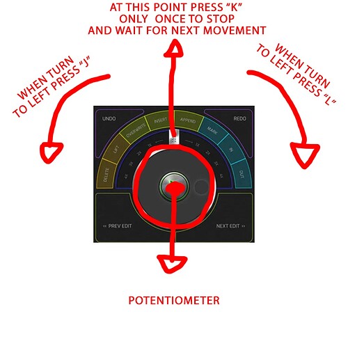

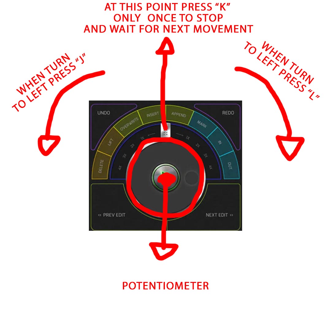

I'm putting an image with the idea of this project and what I would like the arduino to do.
If you could show me how it would look in the code or how I can implement it in the initial code that I already did, it would be of great help if you don't ask for too much.
thanks in advance.
