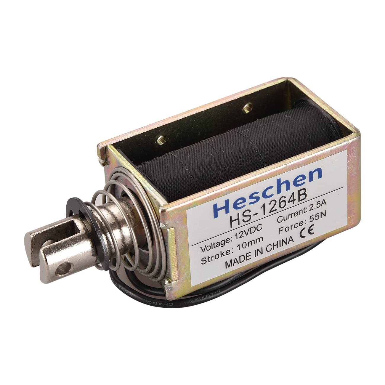

These are the solenoids in question
toggling on/off with the same interval is different than different times for on and off
you can't just toggle anymore for having that functionality.
post a timing-diagramm that gives an example how the different on/off-times look like
And then you should write your own attempt how to code this.
This attempt can have bugs or even not compile. But you should start learning programming.
And this is not by presenting ready to use code but by own attempts and asking specific questions
best regards Stefan

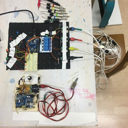

Hi @paulpaulson
I am designing something like this but not exactly.
It is something simple ...to have 4 solenoids drumming at different rates and controlling these rates in real time with the potentiometer knobs
thanks for the advise and your time Stefan, sadly I have been attempting to learn to code without effort for years now. This doesn't discourage me from continuing to come up with new DIY gadgets to make sound. Unfortunately I have to continue asking specialists about technical programming issues and such :blush: .
Regarding the code for the 4 solenoids, I have the code that I use on another system that only uses one solenoid and it looks like this: (the thing get complicated when there are 4 solenoids at the same time)
