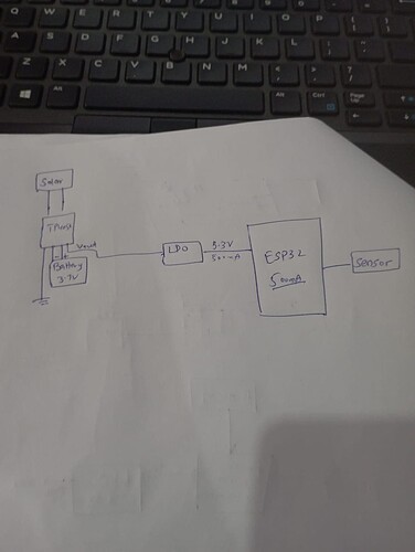

I am creating a PCB design to power an ESP32 using a 3.7V lithium battery, which will be charged via a 5V solar panel and TP4056.
The main challenge I face is selecting an LDO (Low-Dropout Regulator) to convert the battery voltage (ranging from 3.4V to 4.2V) to 3.3V for the ESP32. The ESP32 will send data to the cloud through Wi-Fi, consuming approximately 250-300mA of current, and I will also connect a JSN-SR04T Waterproof Ultrasonic Sensor Module to the ESP32. To ensure reliability, I need an LDO that can provide at least 500mA, but I'm concerned about the dropout voltage.
I’ve noticed that most LDOs have a dropout voltage ranging from 300mV to 1000mV. Some tutorials recommend using the MCP1700-3302E and HT7333, but their output current is limited to 250mA.
Many applications use battery-powered ESP32s, and I wonder what solutions they implement. Any recommendations would be greatly appreciated!

You won't find an LDO that can provide a 3.3V regulated output from 0 to 500mA over that voltage range, they just don't exist.

I think you will find that the Torex LDO will work fine with an ESP32. The ESP32 will run down to 3.0V, and even if battery voltage is low enough than it's not satisfying the dropout requirement to regulate at 3.3V, I think the Torex output will just follow the input voltage on down even if it's not regulating anymore. And since the input is a battery, the supply will still be pretty smooth. But you can test all this, and should.
The TP4056 is not the perfect chip to use with solar, but it will work well enough if there are repeated periods during which your total load current is low enough that the TP4056 will terminate charging when the battery is fully charged. If your load current is always higher than the termination current (see datasheet), then you will continue to charge the battery after it is full, which you should not do. I should say though that Big Clive says even that is ok.
