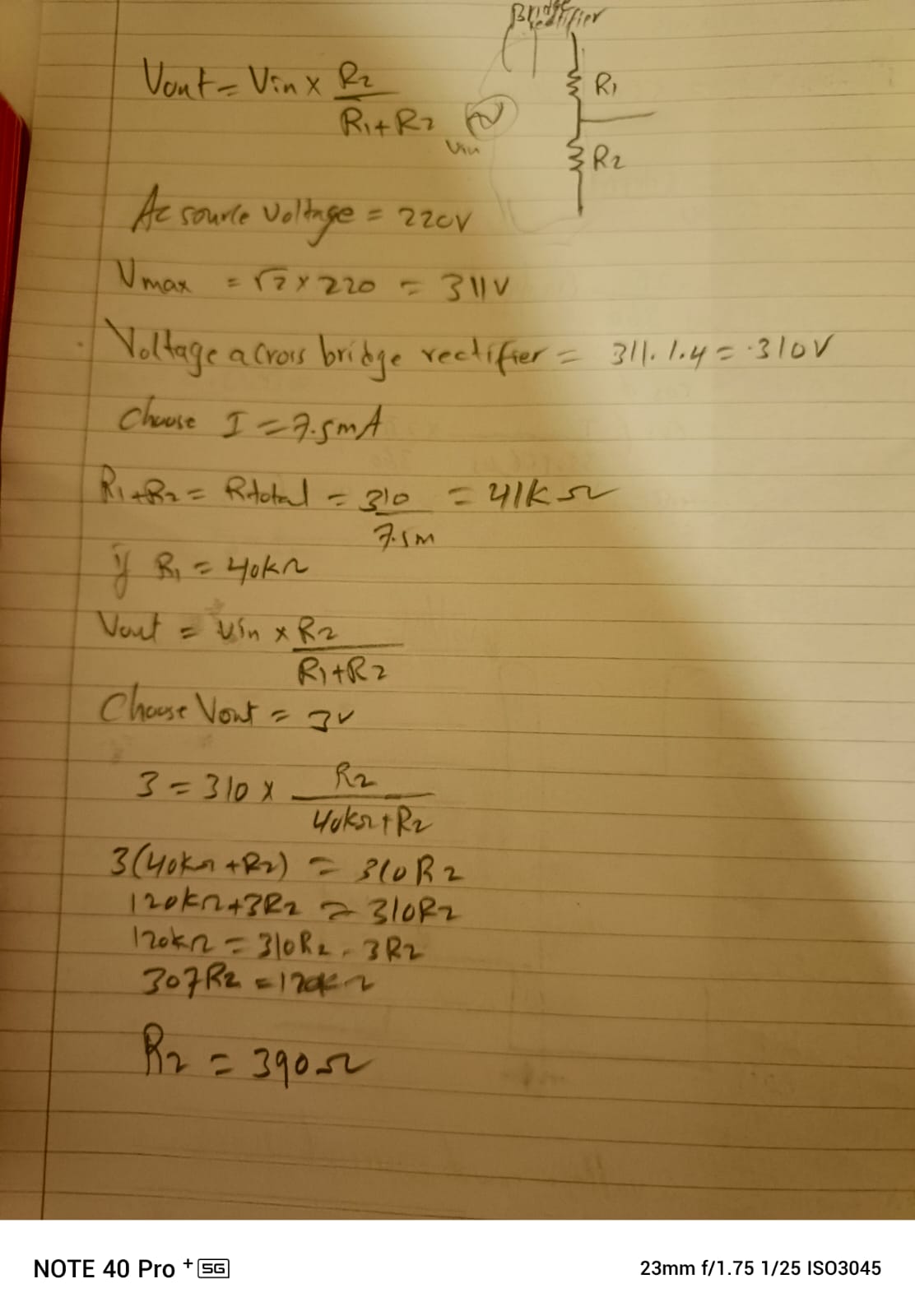

I am working on a power factor measurement project using an Arduino, and I need help debugging my circuit and code. The setup includes: 220v voltage divider vout=3v , R1=40K,R2=390 take I=1.75mA
AC Source Voltage=220V
V
max
=√2×220=311V
Voltage across the bridge rectifier= 311-1.4= 310V
Choose I= 7.5mA

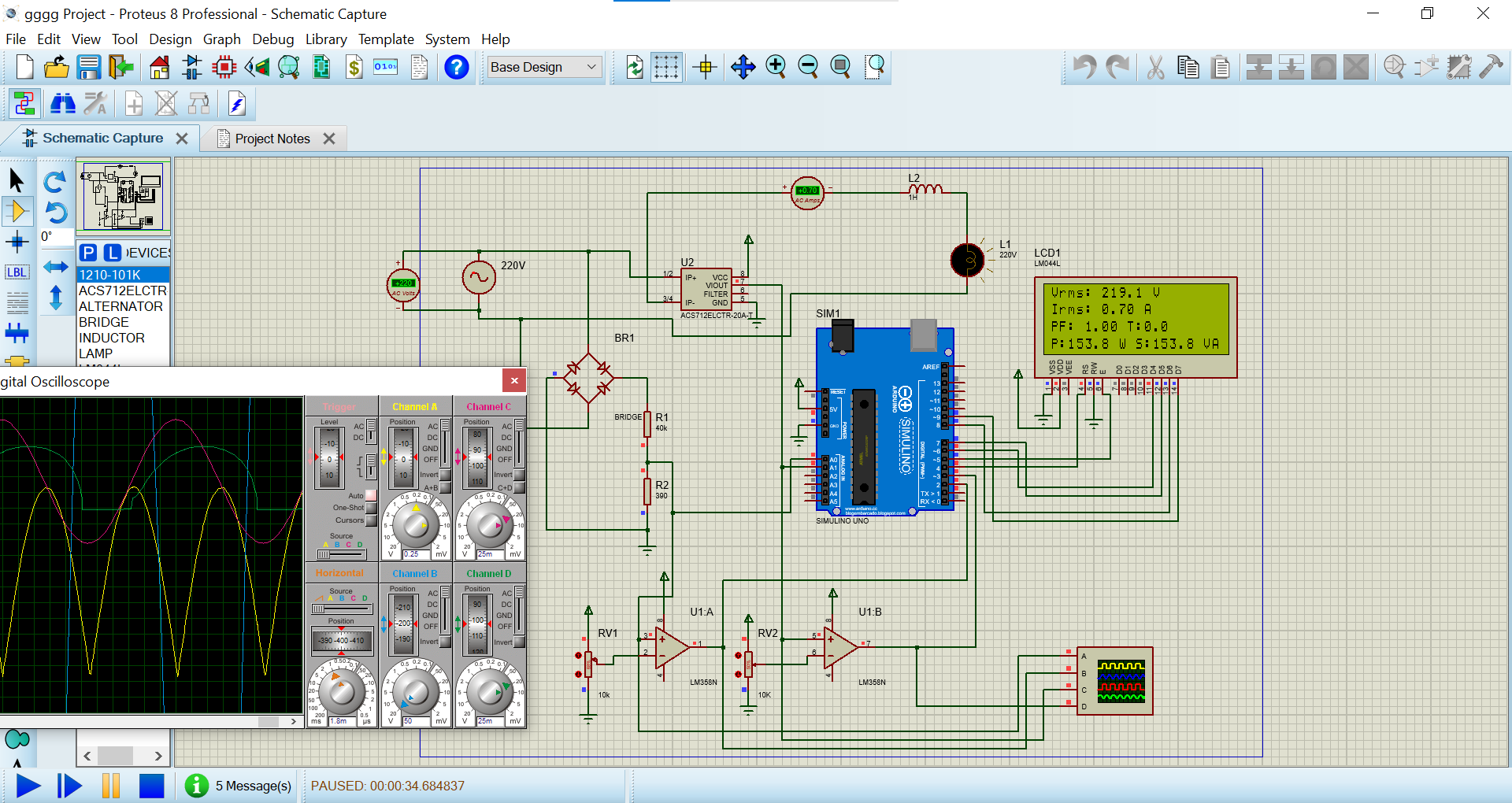

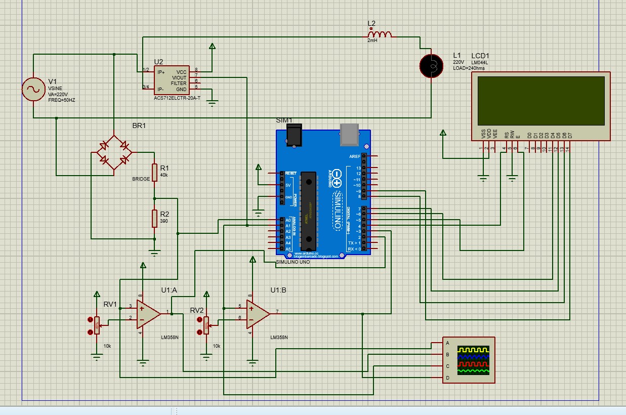

i shared the circuit design
can you create thec code of this circuit design please and share
I think you misunderstood; the forum is not a free software factory.
Please tell me you have not connected that circuit to mains.
What is your level of electrical and electronic knowledge? The whole thing is live and if any part of it is connected to earth, for example by plugging in a USB cable from your PC, it will go BANG! , as will your PC.
How exactly are you intending to measure the power factor? Do you have anyway of varying the power factor for testing?

The circuit is "dangerous", though under fully autonomous operation, nothing should happen beyond potential electronic failure if faults occur. However, never connect it to anything else simultaneously, and of course, never connect it to a computer via USB.
To detect zero crossings, you need to monitor the signals arriving at each op-amp (operational amplifier).
For U1:A: The voltage input comes from a full-wave rectifier, so it will never have negative values. Adjust RV1 to a low enough value so that the op-amp output remains saturated most of the time and stays at zero for the shortest adjustable duration.
For U1:B: The voltage input comes from the ACS712 sensor. When it detects 0 amps, the output is Vcc/2, so adjust the negative input of U1:B via RV2 to this voltage.
Additional note: As a third-year engineering student, you should know that in real-world applications, the phase shift in zero crossings between voltage and current is not always indicative of real power factor; it’s only valid when the waveforms are fairly sinusoidal.
this is my circuit design and the code when i run the code i get pf=1.00 theta 0.00 always even i connect inductor 1H and lamp
i was expacting to get 0.63 when the load inductive is 1H
how can i solve this issue
