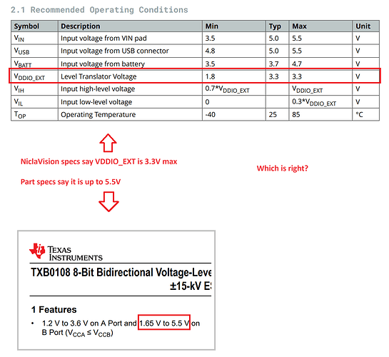

I want to power NiclaVision not with a battery, but with external 5V power supply.
I also want 5V on its digital outputs.
Can I simply supply 5V as per drawing below?
This "the buck convertor must be shut down" in specs confuses me - how do I shut it down?

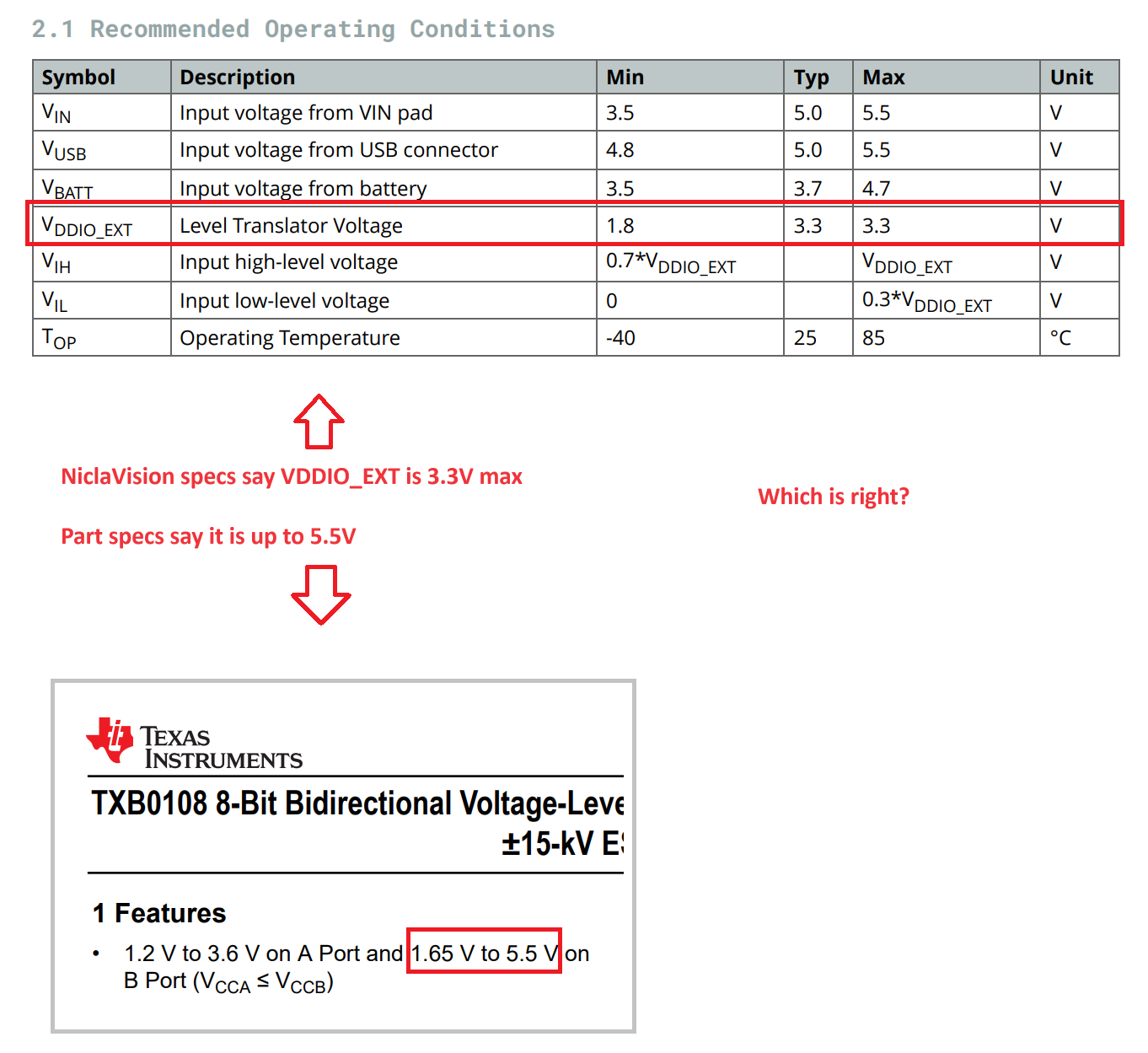

Also a bit confusing that specs say VDDIO_EXT max voltage is 3.3V, while TexasInstruments say in its specs that it is 5.5V. Which one is correct? Can I supply more than 3.3V on VDDIO_EXT?
