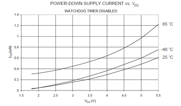

(2) Is 0.46 uA "good"?
Agrees with the data sheet.
