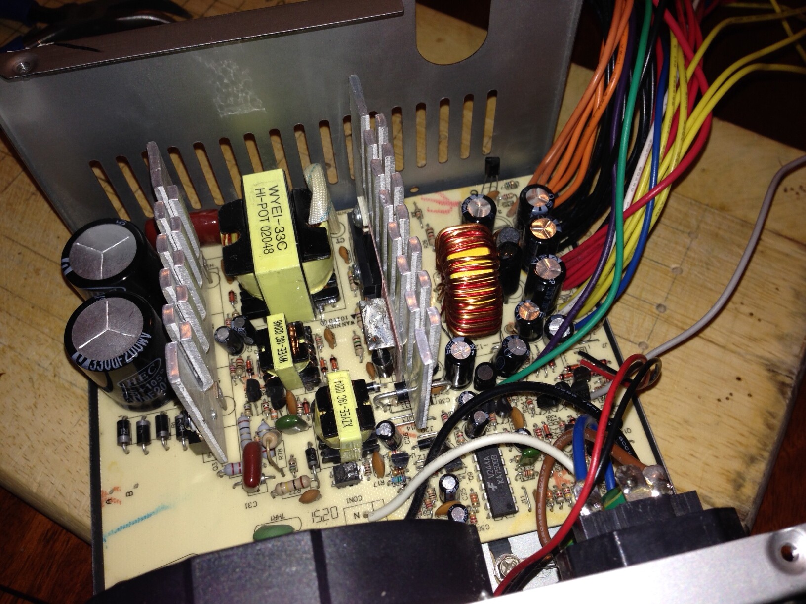

I've recently came up to an old computer and I decided to scavenge it's power supply, but I'm facing a weird issue: it doesn't power up.
This is ATX v2.03 300W PSU and I've cut all the connectors and wired it as in the attached diagram, but the "Power On" LED never turns on while the "Stand By" one turns on as soon as I plug in the mains cord (as expected).
I've added additional resistor loads on each power line as I read it might be required by some PSUs, still with no luck.
The PSU fan never starts spinning and I can see a fraction of second of current and voltage on the power lines, then everything goes down to 0.
Now, the guy who sold me the PSU swears it was working nicely in his old PC and I've checked the fuse for continuity.
When I switch on the PSU by pushing the PowerON green wire down to GND I can hear a very short "buzz"coming from what I recognize as a transformer (the three black and yellow things in attached picture). I don't believe such "buzz" is normal, but my guess it's it isn't.
Any advice or suggestion?

The original fellow's problem is that the power supply is activating a safety mechanism and shutting down. I suspect it is the over-voltage protection if you are not providing a load to it - you need to draw at least an amp or so from either the 5V or the 3.3V supply for the switching regulator to stabilise.

The 12V rail resistance reading is wrong.
It should read around the same as the 5V rail resistance.
It looks like either a shorted capacitor or a shorted diode for the 12V rail.

That sounds almost certain. The trick is of course, that if your meter applies a voltage in the direction that make the rectifier conduct, you will read the voltage drop of the rectifier rather than a resistance as such. On most multimeters, the voltage applied to measure resistance will be less than a silicon rectifier threshold, but these PSUs generally use Schottky diodes with a very low voltage drop, so may read all sorts of things. The "diode test" range on the meter offers a somewhat higher current to charge capacitors and directly read a diode voltage drop.
In the other direction, applying positive voltage to the positive outputs and negative to the negative, you will see a varying voltage as the capacitors charge, and then it will settle at quite high value, at least in the kilohms range except for whatever resistors are sensing the voltages to control the regulator. This resistor will generally be on one line only.
rlogiacco:
May I ask you a little bit more detail, may be a link or something? The PSU is already fused, I was trying to add an additional protection on top of the internal one, trying to save the internal fuse from my fat fingers :-D.
On a PC power supply, the negative goes to the mains ground. If a fuse in the ground line as you describe blows, there can still be a return path through the mains ground and other equipment connected to your circuits, or through another one of the supplies and whatever heavy current blew the fuse, may be directed through something else. Need I point out how that could be a problem?
The mains fuse inside the PSU is only to protect it from internal faults. A short on any of the outputs should shut down the switchmode system- as it appears to be doing here.
So what to do? Unsolder and remove the rectifier from the 12V line. Test it. Look for any connection to the regulator circuitry - if it is (and it most likely is) either 5V or 3.3V that is regulated, then the PSU will run without it.
