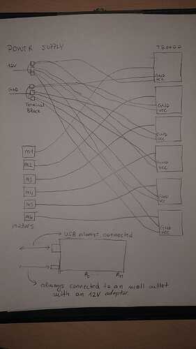

It was working very good when I connected only a single motor. All hell let loose when I connected all 6 of them. Power supply wiring is correct, all parallel 12 V and GND coming from it. In my theory, if I can make a single clone move the two steppers without causing any issues, I can connect the other two. Sadly I don't have any ideas other than this.

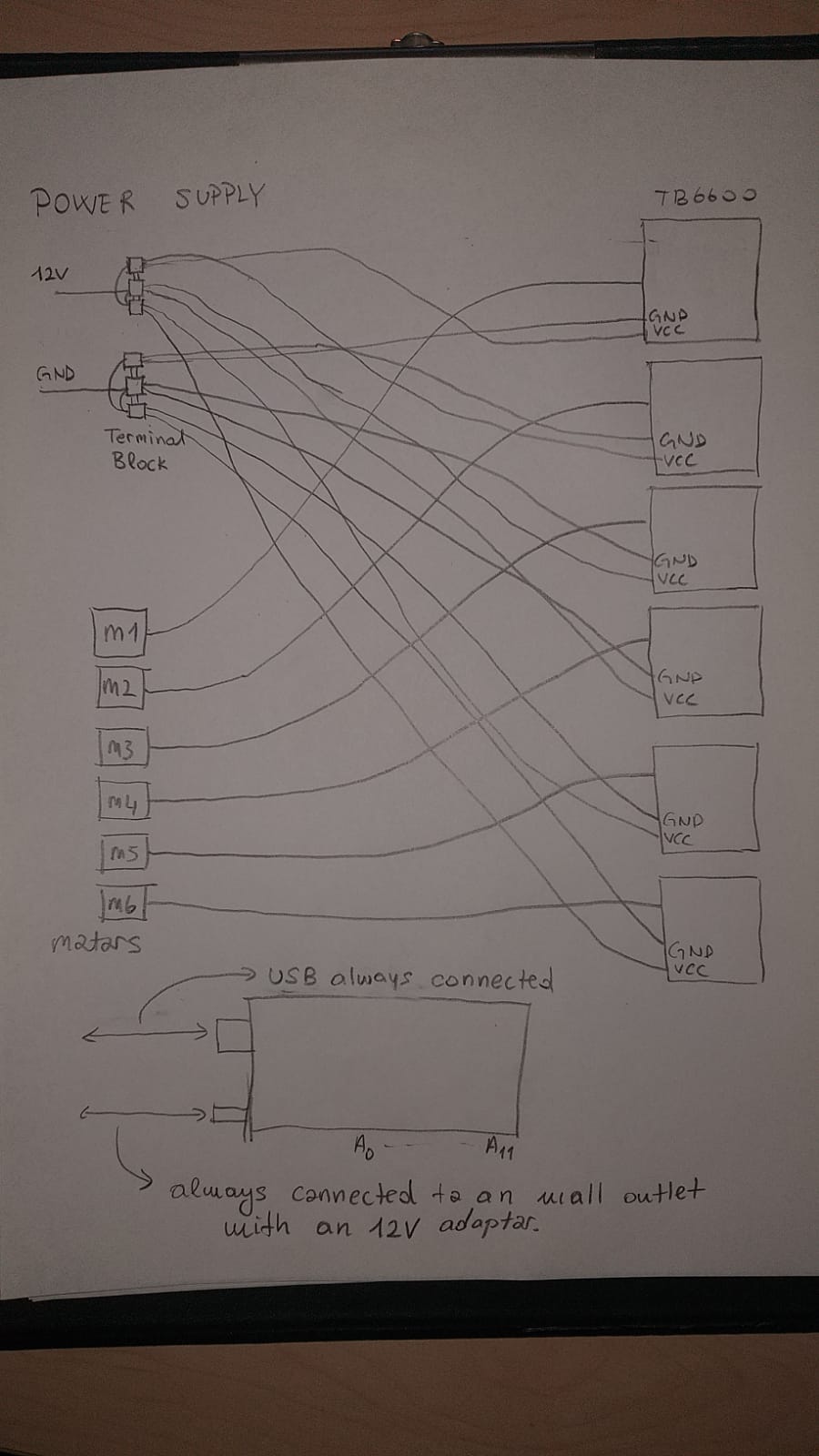

Perhaps if you made a photo of a hand-drawn wiring diagram (although you have now disassembled it, so you can't), we might be able to see something. At this point connect one, post all the code in code tags, and post the photo of a labelled hand drawn wiring diagram that we can read. We go from there.
A+,B+,A-,B- connection are done according to the manual (there were total of 8 cables, but I didn't want to make it even more complicated). Step and direction pins were connected to the Arduino starting from A0 to A11 with sequantial order (A0 A1 is used for step and direction for motor 1, A1 A2 for motor 2 etc.). I grouped (peeled, connected and secured with a heat shrinking sleeve) two of the logic grounds from drivers together (total of 3 ground cables). I directly connected them to the ground ports of Arduino. If any more explanation needed, please tell me. Thank you for your time and answer.
2 quick things. Connect the ground terminal block to the arduino ground. Lose the 2nd arduino power cable, just use USB. There are logic connections missing, your first photo is very different from the last.

First photo is exactly the same as my logic connections. I didn't add them to my drawing to reduce complexity. I will apply your suggestions.
First diagram.
Curious why ENA+. and ENA- are both connected to ground ?
Shouldn’t cause your problem, but it won’t work like that !
Maybe indicative of other wiring problems…

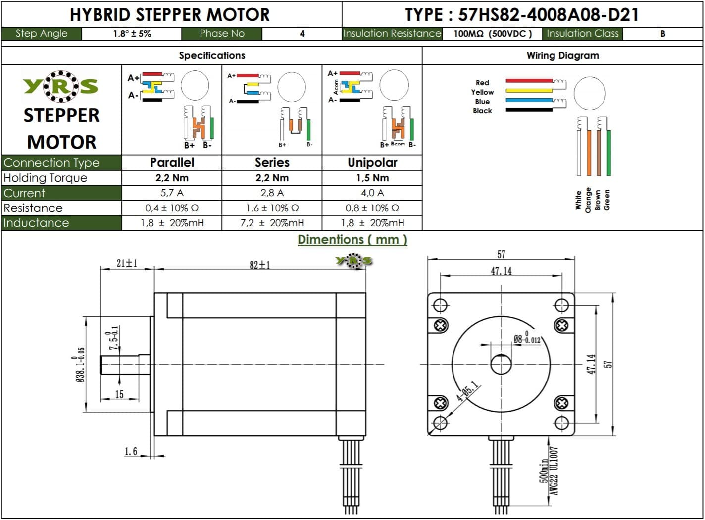

Stepper motors can only draw 2.2 A peak (it is arranged in that way, current limiting) from the drivers. I have 6 working at 12 V, if I am not mistaken it equates to 158.4 Watts.
Sounds sufficient.
Also, you are not limited to use only PWM pins or analog pins, any pins are good (afaik common libraries don't use pwm for stepper control).

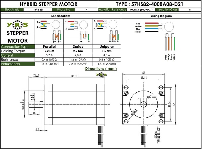

I think your calculation is wrong. The 2.2A you set at the driver is per coil, not per motor. And to calculate the needed power you need to know the coil resistance. ( P = I²*R ). The voltage of the PSU is irrelevant when calculating the needed power for the stepper.
This is the exact model of my stepper motor, it is wired in parallel.
