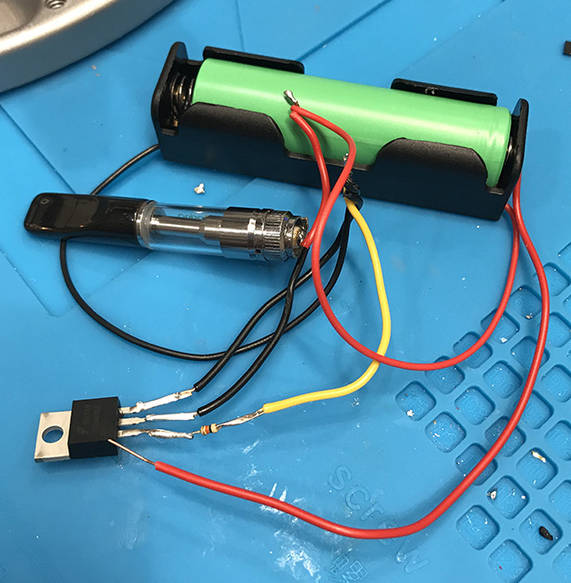

@JCA79B, I tried what you suggested and I was experiencing similar results, although the voltage drop wasn't as bad. Instead of getting 0.1v with the heating element connected, I'm getting roughly 0.6-0.8v. Here's a pic of the setup:
@TomGeorge, here are some pics of the breadboard. I cleaned it up a bit to make it easier to see. I verified that I'm getting the same results.
Here you can see a decent voltage without the heating element:
And then the voltage drop with the heating element:
Here's a close up of the wiring:
Some notes:
  • After cleaning up the breadboard and reducing the # of rails carrying a pos/neg load, down to just one rail, I'm seeing a higher voltage across the element then having all the rails of the breadboard hooked up. But its still not enough to produce any heat.
  • The battery power to the heating element was isolated from the ESP32. I powered the ESP from USB.

What is the part number of the MOSFET?
Gate voltage of 3.3V is probably not enough to turn the MOSFET completely ON.

The MOSFET is part #: P30N06LE

Here are some more measurements:
With the Original P30N06LE MOSFET:
  • Battery Voltage: 3.8v
  • Ground to MOSFET Gate (pin on): 3.29v
  • Ground to MOSFET Gate (pin off): 0v
  • GND to ESP32 Output Pin: 3.29v
I tried a IRF3708 MOSFET and was getting a slightly higher voltage to the heating element. Roughly 1.6v versus 1.3v. But still not enough to heat up the element.

Perhaps the gate resistor is the wrong value or bad. You should be measuring point C right at the gate of the mosfet, not at the esp32 output pin. Gate voltage should be 3.3 volts.
Another possibility is voltage drop in the breadboard which you’ve already seen. But, overall, I question if a 400mAh battery can supply a 2000mAh load for any length of time.
It looks like MOSFET cannot turn fully ON with 3.29V on the gate.
What is the gnd to source voltage with gate ON and OFF?
If you disconnect the gate resistor from the ESP32 and connect the resistor to the Lipo positive. So the MOSFET gate is connected to the Lipo positive.
What voltages do you get?
