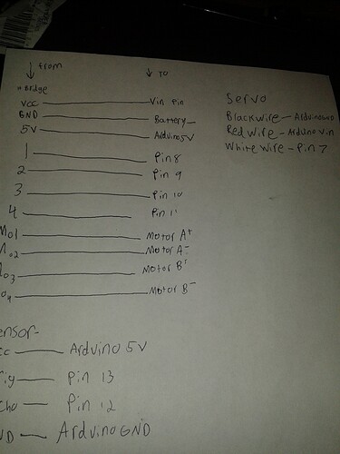

Currently at the moment I have the Vin pin connected to the positive end of the where the battery pack is(the + sign half of the breadboard). The only other wire I have connected to that half if the VCC pin of the H-bridge. On the other end of the battery pack(the - sign half of the breadboard) I have a wire connected to Arduino GND and the GND port of the H-bridge.
And also AWOL the program that I wrote is just the example for stepper motors because I used to think these were steppers. My mothers fiance has a model that is almost exactly like this and his works perfectly fine running off of my code. SO that leads me to believe it is something to do with the wiring, whether it be I have a wire in the wrong place or I need an extra wire.

Can you post a picture of your project and can you please post a copy of your circuit, in CAD or a picture of a hand drawn circuit in jpg, png?
Tom.....
Your attachment on where everything is connected is okay, but a circuit diagram will make your project easier to check.
