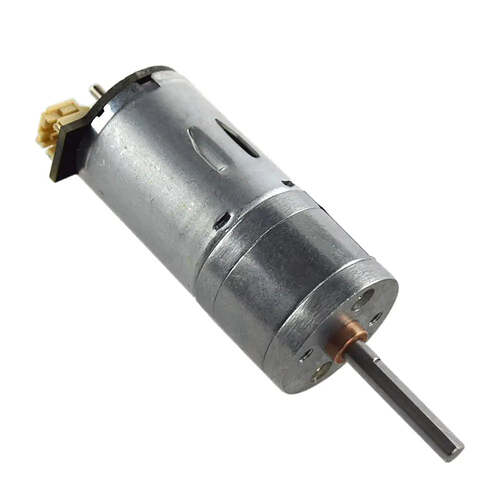

I am a bit confused with powering the Arduino and a motorshield (Adafruit Motorshield V2). I have 4 18650 Lithium batteries. This results in 4 X 3.7 = 14.8 V.
Reading the Adafruit information, it says to power the shield seperately. So does this mean I use my 14.8 V for the shield and then use 9V for the Arduino? Thus needing 2 power supplies?

I have 2 6V DC Motors.

You can use a stepdown converter to power the Arduino from the motor power supply. The simplest option is to use one of these 5V converters or similar, and connect the 5V output to the 5V Arduino pin. There are also 7 to 9 V versions of such regulators that could be connected to Arduino RAW or Vin.
Don't forget to connect all the grounds.

You can power both Arduino + the shield with motors from one source, but motors generate noise, and you might need to filter that out. It's all in the FAQ.

Nominal. But 17V when those batteries are fully charged.
And that shield is rated at 13.5V.
And your motors at 6V.
You have to find power supply / battery that fits the specs of your motor.

Why use 4x18650 batteries in series when you could use just 2, thereby avoiding both converters?
Thats actually an obvious solution. Thanks.
Probably silly question, will 6V motors be OK with this, as it is still slightly higher. The Arduino says 7 - 12V, so it will be fine.
Brushed DC motor voltage ratings are nominal, not absolute maximum.
A general rule is that the higher the motor driving voltage, the shorter the motor lifetime.
Post the specs of your motors. Or link.
There's no max voltage given, neither datasheet.
Some vendors (like Mouser) are selling it as 9V motor though...
You could contact your vendor and ask max voltage.
