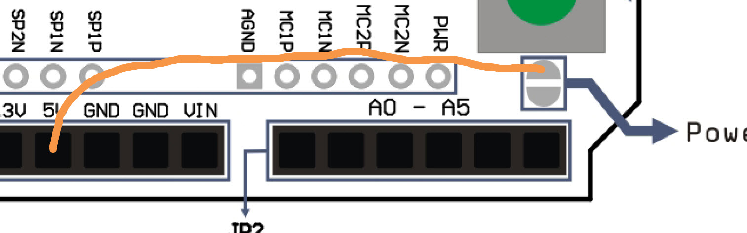

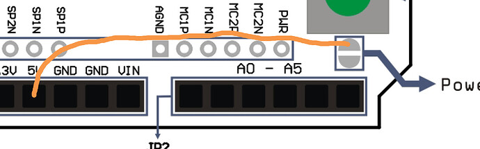

Alright, try this but it's on your own head.
Connect a resistor (around 1k) between the 5v socket and the half of the solder bridge that's nearest the power switch, as shown in the attached pic.
With luck this will turn Q3 on which in turn will shut down the module after 100mS.
If that works maybe we can figure out a more permanent solution.
