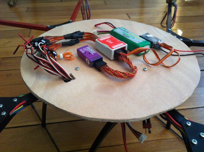

The joined picture shows the Sparkfun wires I use to input the PWM signals, and the following code is one of the two I’m using.
It reads 4 different ports and sends the measurements to an embedded PC (Pico-ITX) through a serial port.
I code each measurement with an ASCII character, so I have a resolution of 4 ma, which would be sufficient for me… But 20 ms is a little bit bigger !!!

Thank you for your answer... So 20 ms is too big... I'm also going to check if it comes from the R/C receiver.

OMG, I’m so confused (shame on me)… In fact, I didn’t provide you the correct unit.
The error I get is not 20 ms, but 20 µs !!! I’m so sorry for this misunderstanding… !!!
In fact, Grumpy_Mike, the embedded PC gets the measurements with a rate of 80 Hz (I think it comes from the serial port which is, for the moment, configured at 9600 bauds…). And I joined the second picture (in my first post, which is a zoom in of the first one) to illustrate the error I was talking about.
If I don’t touch the Radio sticks, the mean is 1503 µs, but I got a lot of 1511 µs measurements and 1492 µs measurements…
Is 20 µs a proper value of precision ??

I also tested your code, and I got the same +/- 10 µs of error than with the other... Do you experienced this same kind of error ??
You are so right for the protection on shared variable access, I'll use your code in the embedded electronic to solve this major trouble thanks again.

Hi, Yes I do get a 4 or 8us error, its is unavoidable and due to interrupts queuing up. For example if a timer fires, then an input pin goes high and then another input pin goes low, one of the ISRs will have to wait for the other complete one after the other before it can be serviced, this takes around 8us.
It works out at about a 1% error across the 1000us to 2000us range of an input signal.

In fact, I think that my bigger errors could come from the fact that:
  • I read 4 inputs in the same time (according to your interrupts queuing explanation, this could decrease the accuracy)
  • I encode the signal with a ASCII-like octet (to be sent by the UART) and I decode the signal, so I have a resolution of 4 µs which add additional error
  • I performed the ‘table’ tests with a E-sky radio which is maybe not the best one…, but I have a MX12s for my Oktokopter
The project I have is to read the PWM commands input (of a DJI NAZA board) and the gyroscopes rates of an Oktokopter, to be able to determine its non linear model, and after hours of Google, I have concluded that the Arduino board was the best solution to transform PWM signals into UART… !
You also right, I really have to smooth the commands, I think I’ll test your algorithm !! If I find another one, I’ll provide it to you…
