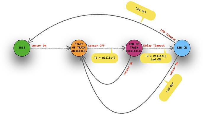

Press a button and when released switch off led with delay
Hi, for my modeltrain I want to make an infrared light barrier which after passing the last wagon releases another track with some delay. I want to use millis(0 or millisDelay(0 to get this done but alas my coding is very bad. I already got this but want to add a button (the light barrier) to it.

Hi @anon37033065 ,
congratulations to your normal worded description. This is a very good starting point.
lot's of newcomers do not explain in normal words but describing the wanted functionality in normal words is very helpful.
OK: So a lightbarrier is interrupted through a train. All the waggons pass by and after the last waggon has passed by the state of the lightbarrier changes from interrupted to not-interrupted.
This state-change has to be detected.
If state-change happend start timer.
The function
justFinished()
gives back a "true" only one single time.
consecutive calls to function justFinished() gives back "false"
until the timer is started new. This can be used here but is an important detail to know.
state-change-detection is done by comparing the state of the last iteration with the actual iteration of function loop()
This means you need a new variable. All names in code should be self-explaining
You are dealing with a lightbarrier that detects "train passing" or "no train passing track free"
or maybe you like "trackInUse" / "trackFree"
or "waggonCrossing"
all examples that explain what is going on.

you could read about state machines and the diagram could look something like this:

Nice pic @J-M-L : what tool did you use to draw that?

a)my understanding was this is an IR interrupter, not a physical button to be pressed, my responses are informed as such (correct me if im wrong)
b) if all he had to do is a single digitalwrite() inside the isr, that works fine. but since he needs a delay, I'd set an internal timer inside the external isr...that is probably overkill for his application, but thats how my mind would do it.
c) what do you mean "blocks millis" ?
Depending on which IR components are selected and the geometry, you can still have some bouncing (due to indirect paths for the signal). You can deal with that in hardware though so it could be considered perfect.
for b) indeed that's my point - you add complexity as you need to handle two delays and need to cancel the timer if a new train comes by during the delay period or whilst the led is on.
just as a hint on complexity, assuming no bouncing, the state machine as described in post 4
could be implemented as such

that's easy to read by just looking at the state diagram, likely will do the job, easy to maintain and requirement changes are usually easy to implement in a state machine structure.
That's why I'm not convinced (but would be happy to see your code and become convinced) that the ISR based approach with the delays, volatile, timers etc could be "superior in every way"...
