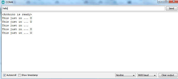

Sorry for my late reply, yes I saw that didnt compile. And i saw that i didn't copy it over what was written there in my sketch.
in showNewData I wrote rows and columns
void showNewData()
    if (newData == true) {
        Serial.print("This just in ... ");
        Serial.println(array1[ rows ][ columns ]);
        newData = false; }
But I tested it and this was the one that compiles. But nothing comes out of it or rather some weird symbol gybberish(see attachment).
So i wanted to see if what I did was that i tried to print the byte from rows and colums( both were specified as 3 and 6). So I changed the code to
Serial.println(array1[ 1 ][ 1 ]);
I only typed in one byte the letter h to see if that gets printed, but even that doesn't work.
There is quite a bit wrong with your program.
For instance each row of the array is not terminated with a '\0' so you can't print a single row and even if you could then
would only print one byte
Please describe exactly what you are trying to do.
