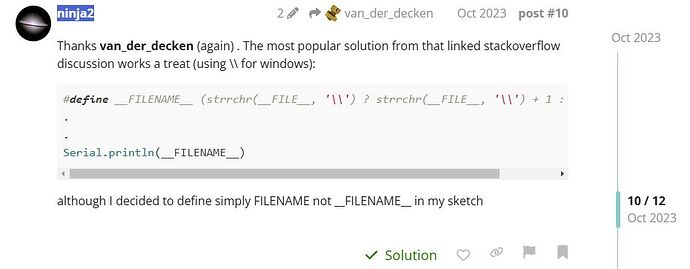

You introduced an error into the code. If you look at the code from the referenced topic:
You can see that the macro referenced in the Serial.println call is named __FILENAME__. But in your sketch you instead referenced the __FILE__ macro:
Is the problem that in the original post, you defined '__FILENAME__', but then went on to print '__FILE__', rather than what you had just defined?
@ptillisch , @JohnLincoln
Yes, thanks both, that's the puzzle solved!

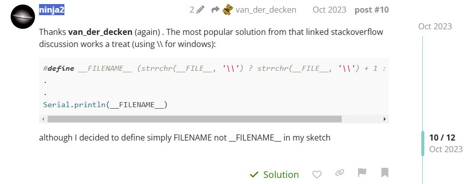

To understand where I introduced that unwanted change I've looked again at that year old source, post #10 by @ninja2 :
Still not sure what initially changed my working two-liner, after a year or so. But that sent me looking for the original source and I'm guessing that's when I changed it to FILE . If so, at least I added the missing semi-colon.
That works perfectly, thanks for your patience!
