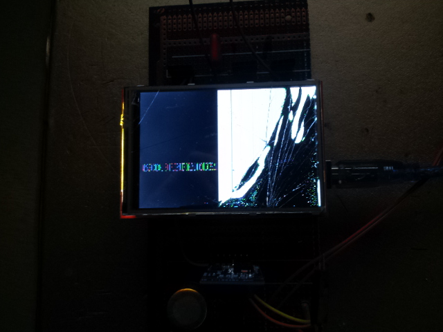

Hi David,
Thanks again - I tried what you posted but get what is shown in the attached photo.
It starts with green "WINDOW SCROLL" then what you see in photo but scrolling right to left.
(You may remember from previous thread that my TFT arrived smashed)
Second example is similar but moving faster.
I do get what you are doing in essence I think .... which is to shift the graphics memory around
at high speed to simulate scrolling. I will try and do this sometime.
The actual TFT is shown here ...
Thanks again
Well, I will avoid Ebay seller "lakeyx101"
I have ordered one from "sag222" because he has sold 130 of them.
Yes, I think we have discussed the fact that your ILI9486 reads 16-bits from GRAM memory. The library was reading 24-bits per pixel.
It is already fixed in the next release of the library.
I can't see much point in using a smashed screen. Are they sending you a replacement or refunding your money?
David.
