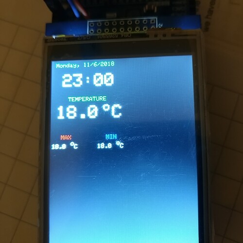

printText or 'dtostrf' fault?
Error
Arduino: 1.8.5 (Windows 10), Board: "Arduino Due (Programming Port)"
C:\Users\Johan Prinsloo\Documents\Arduino\RTCTFT160\RTCTFT160.ino: In function 'void setup()':
C:\Users\Johan Prinsloo\Documents\Arduino\RTCTFT160\RTCTFT160.ino:55:43: warning: deprecated conversion from string constant to 'char*' [-Wwrite-strings]
    printText("TEMPERATURE", GREEN,30,65,1);  // Temperature Static Text
C:\Users\Johan Prinsloo\Documents\Arduino\RTCTFT160\RTCTFT160.ino:56:34: warning: deprecated conversion from string constant to 'char*' [-Wwrite-strings]
    printText("MAX", RED,18,130,1);
C:\Users\Johan Prinsloo\Documents\Arduino\RTCTFT160\RTCTFT160.ino:57:35: warning: deprecated conversion from string constant to 'char*' [-Wwrite-strings]
    printText("MIN", BLUE,95,130,1);
C:\Users\Johan Prinsloo\Documents\Arduino\RTCTFT160\RTCTFT160.ino: In function 'void loop()':
C:\Users\Johan Prinsloo\Documents\Arduino\RTCTFT160\RTCTFT160.ino:102:33: warning: deprecated conversion from string constant to 'char*' [-Wwrite-strings]
    printText("o", WHITE,90,75,2);
C:\Users\Johan Prinsloo\Documents\Arduino\RTCTFT160\RTCTFT160.ino:103:34: warning: deprecated conversion from string constant to 'char*' [-Wwrite-strings]
    printText("C", WHITE,105,80,3);
RTCTFT160:108: error: 'dtostrf' was not declared in this scope
      dtostrf(maxTemperature,4, 1, charMaxTemperature); //float,string var incl dec,digits,array to store the results)
C:\Users\Johan Prinsloo\Documents\Arduino\RTCTFT160\RTCTFT160.ino:111:36: warning: deprecated conversion from string constant to 'char*' [-Wwrite-strings]
      printText("o", WHITE,35,140,1);
C:\Users\Johan Prinsloo\Documents\Arduino\RTCTFT160\RTCTFT160.ino:112:36: warning: deprecated conversion from string constant to 'char*' [-Wwrite-strings]
      printText("C", WHITE,41,145,1);
RTCTFT160:118: error: 'dtostrf' was not declared in this scope
      dtostrf(minTemperature,4, 1, charMinTemperature);
C:\Users\Johan Prinsloo\Documents\Arduino\RTCTFT160\RTCTFT160.ino:121:37: warning: deprecated conversion from string constant to 'char*' [-Wwrite-strings]
      printText("o", WHITE,112,140,1);
C:\Users\Johan Prinsloo\Documents\Arduino\RTCTFT160\RTCTFT160.ino:122:37: warning: deprecated conversion from string constant to 'char*' [-Wwrite-strings]
      printText("C", WHITE,118,145,1);
exit status 1
This report would have more information with
"Show verbose output during compilation"
option enabled in File -> Preferences.

Ive read the 'dtostrf' on this forum and others and it seems like its still not working. I'm not sure if its maybe the printText ?
Any case I need professional help as Ive been stuck on this for a long time. Thanks[/code]
The warnings should be fixed by:
void printText(const char *text, uint16_t color, int x, int y,int textSize) {
is that for every line printText? Thanks
fnb111:
No. You should change the signature of the method/function, in one place.
No, in the function definition.

Thanks for that. I still have the printText error and I'm not sure how to fix that. Ive gone through all and they have 5 declarations each.
Thanks
I have no idea what that means.
But, you changed your code and then failed to post the revised code.
BEFORE you post your code again, though, look through it.
}void printText(char *text, uint16_t color, int x, int y,int textSize)
NO code EVER follows the } of a function, on the same line.

Thanks. I appreciate the help.
Not sure what the problem is. I don’t have all those libraries, so I can’t try to compile it. Maybe an unprintable garbage character somewhere? I’d start from scratch (no copy / paste) and write a small MCVE that just tries the dtostrf() function. Leave out everything else. That way others can try to reproduce the errors.
I did a web search and found this
#include <avr/dtostrf.h>.
The compiler said its included by defalt but I added it and the problem is fixed.
Thanks a lot for your help.
The compiler told you that? I doubt that.
On an AVR board, the IDE might include the file by default. On an ARM board (that the Due has), that would not be the case.
.Thanks.
This is the results
