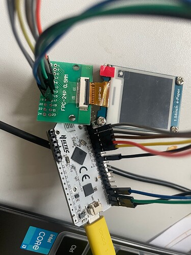

Problem 1.54 ePaper | ESP-32 Wifi Kit V3
Hello :raised_hand_with_fingers_splayed:, i'm strunggling with my ePaper display to have a working code.
I tried on ESP 8266 (with success) and now must get it work on this board.
There is my code (tested with 150_BN & 154_D67 without success) :

Thanks for help ! Have a good day :smile:
Reference :
Screen with modules (Waveshare ePaper 1.54inch V2 FPC-8101) : https://www.waveshare.com/1.54inch-e-paper-module.htm
Board Heltec ESP-32 Wifi Kit V3 : WiFi Kit 32 (V3) – Heltec Automation
@jogoldirus , Hi, welcome to the forum!
You need a connection module with the booster circuit for the panel driving voltages. E.g.
24 pin serial ePaper screen HAT adapter board, DESPI-C02_Good Display (good-display.com).
-jz-
Hi !
I show it and if i understand it's for driver or for resistance ?
I have one of it but throught drivers wasn't mandatory with the library GxEPD2 and provided by GxEPD2 from software
For industrial reason, i try (and need) to avoid HAT or hardware drivers
Look at the schematics of the DESPI-C02 and at the reference circuit of the panel specs.
