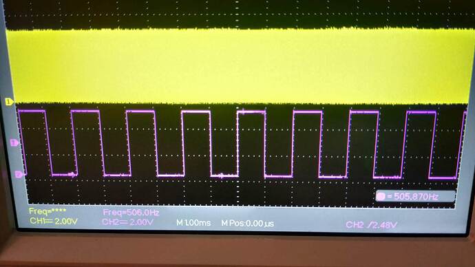

I am facing the problem of timer0 operation impacting the toggling rate of any general digital IO I select and unable to resolve it even after looking on the web for various possible reasons.
My code:
1- uses timer0 for generating 38.4kHz@30% duty cycle at OC0B (pin 5)
2- uses a general digital IO pin for a 200 millisecond ON and 200 millisecond OFF rate (pin 12)
I do get the desired frequency and duty cycle at OC0B BUT the toggle rate of general digital IO is different than I program. This toggling at pin 12 is either faster by a scale of 200 or becomes random. No matter if a change the general digital IO pin, problem is consistent. Also the problem is only with activating timer 0 and doesn’t occur on activating timer 1 or timer 2. If I comment timer0 commands, the output at pin 12 toggles correctly at programmed values. My code is as below:

The above code generates a waveform at pin 12 that is 200 times faster than the code, but if i comment the "TIMSK0 = 0;" part and rather use clear and set interrupt commands (cli() sei()) i start getting an erratically toggling output at pin 12.
Please help me understand if there is any relation at all between timer 0 and any digital IO or if there is a mistake in above approach. I did try to read the relevant sections in ATmega328P datasheet but unable to find any such thing.
I am attaching four CRO snapshots:
*OC0B-out.jpg : OC0B output that is correctly generating 38.4kHz@30%duty cycle
*cli-sei-enabled.jpg : Pin 12 toggle rate when TIMSK0 is commented and cli+sei are enabled
*TIMSK0-enabled.jpg: Pin 12 toggle rate when TIMSK0 is enabled and cli+sei are commented
*timer-0-disabled.jpg: Pin 12 toggle rate (correct as programmed) when timer0 part of the code is disabled
