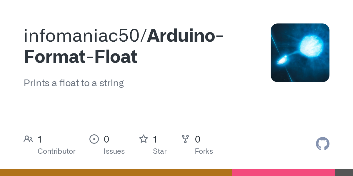

i have seen it and experimented with it but i dont understand it.
could you show me how i must do it with my code?
sorry i am an arduino noob...

Does the example work?
the example puts out the folowing serial data:
+Inf
+Inf
NaN
-0.d: -0.5 4
0.d: 0.5 3
-d.0: -1.0 4
d.0: 1.0 3
