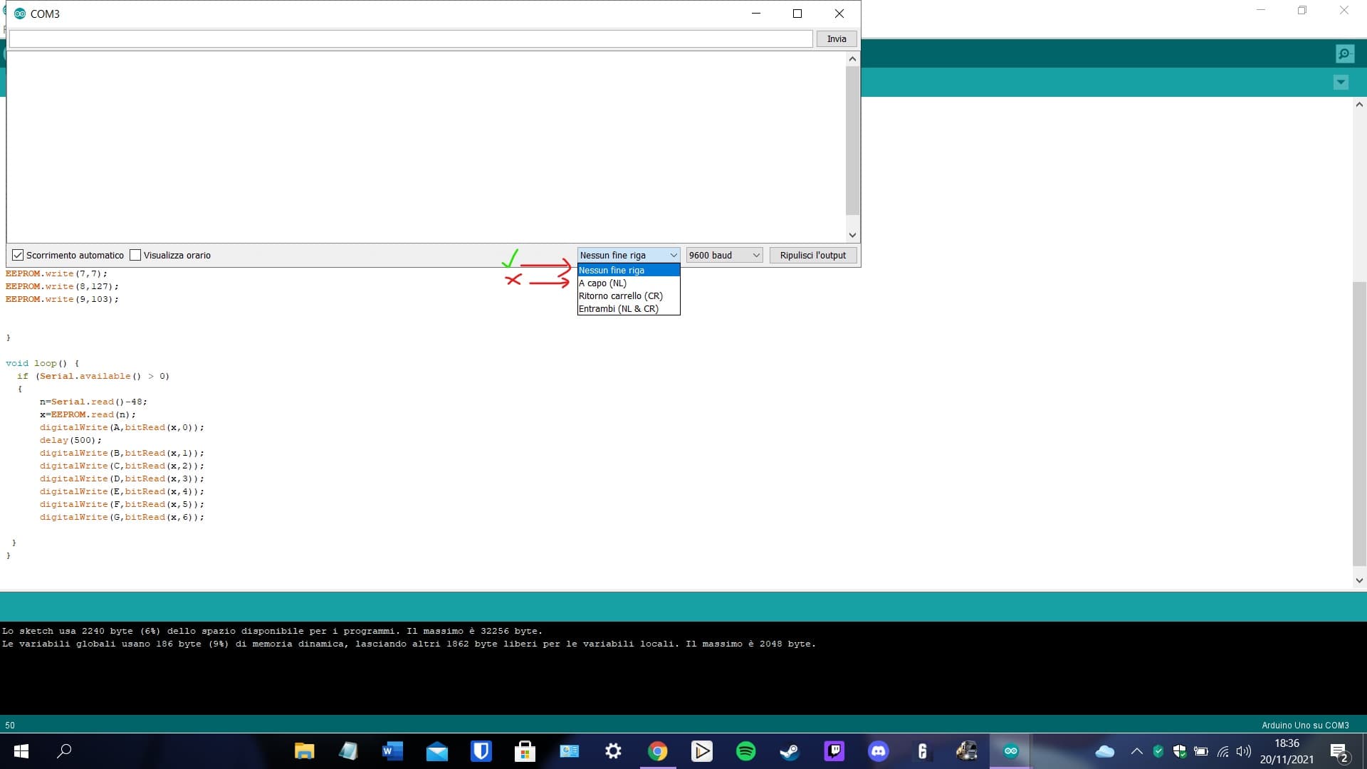

I should type a number from the keyboard and the display should show that one. The hardware is fine but i can't find the problem in the code. When i load the sketch and then i type the number on the serial monitor the display always shows an 8 even i type 0,1,2 or else. datasheet of the display is 5161AS. Can someone help me? the code is below

that one, it's in italian but "Nessun fine riga" is "no endline".
before was on "A capo(NL)" that means "to head" i think. so was the endline yes, thank you man
That's right - the last character your sketch saw would always be newline.
Subtracting 48 from newline give a negative number (-38) which you then used to lookup a blank EEPROM location.
Uninitialised EEPROM contains 0xFF, so all segments lit on your LED display.
