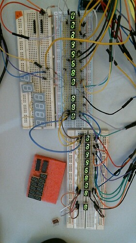

Problem in the display of 20 7-segment LEDs using Arduino Mega2560
I'm using Arduino Mega 2560 to light up 20 7-segment LEDs. In addition I'm multiplexing 20 7-segment LEDs. I want it to display 0-9 in digit1 to digit10 and 0-9 in digit11 to digit20. My problem right it is displaying incorrect numbers.
How should I fix this? This is my code.

This is the output.
You’re trying to do it the right way, but making it hard on yourself.
use arrays well, and functions to soften and simplify your code.
Hello nyal
Welcome to the worldbest Arduino forum ever.
Take some time and investigate the correct ussage of the index-value for the arrays used.

You will see that referred to as "ghosting", where the digit will appear dimly on an adjacent display.
I expect someone there will point out that with this many digits, it might be better to multiplex the segments instead of the digits, that way the refresh rate would be 50Hz x 7 = 350 instead of 50Hz x 20 = 1000. That would require transistors to handle the current of 20 segments lit simultaneously.

What possible reason would you have for slowing down the clock? The refresh rate is going to consume a considerable amount of processor time to begin with, if you have any plans to add code outside of the display itself then the clock needs to run at full speed.
Also, a photograph of a rapidly multiplexing display, this one currently runs uncontrolled at loop speed, will not necessarily match the persistence of vision qualities of the human eye. In the worst case, it will show only one digit position lit and the rest blank. A longer exposure will show all segments on all displays lit with possibly some differences in intensity.
