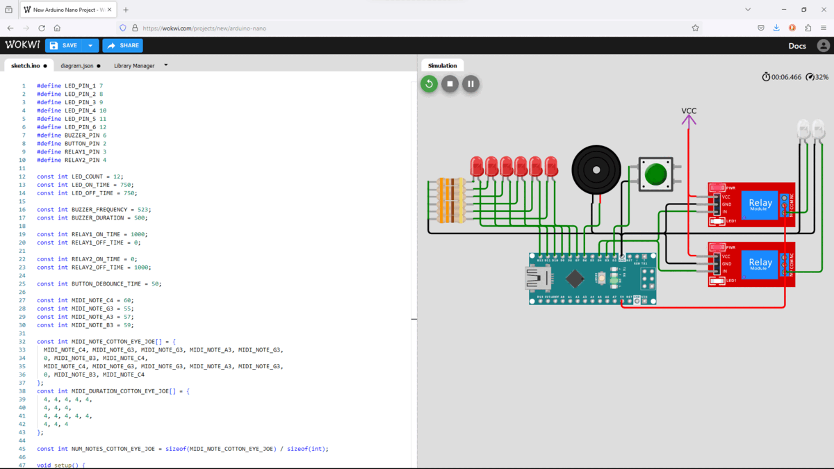

Your sketch only lights a lamp through relay 1 if the button is pressed. The "dimming" you describe is because you are powering the RELAYS with the Arduino.

Your program does not tell us how your Arduino pins, LEDs and relays are connected together.

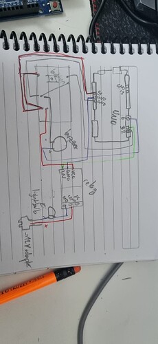

I just realized that I made a doodoo in my code. I was going to use 2 relays but then decided to only use one for the bulb and the others. what Im trying to do is, make a button control the relay. when I push the button, it toggles the leds and then after another push, the lightbulb. I got 2 parts that Im mostly confused with. Firstly, Im trying to figure out if I can power up the lightbulb and the leds etc all with 1 relay. I also connected the lightbulb to a 220V adapter which I connected the positive cable to the COM pin of the relay. Im not sure if that would work with the other components, but it does a great job at lighting the lightbulb. Couldnt figure out a way to connect the LEDs to the relay so I couldnt test it. any suggestions? Im open to anything that doesnt look like a mess cuz Im gonna put it in a kinda slmall space and dont want too many wires to show. thanks in advance
Relays do not supply power. Relays connect an external power source to a load (light bulb).
LEDs take 20mA each. Six x 20 = 120mA... which brings you to...

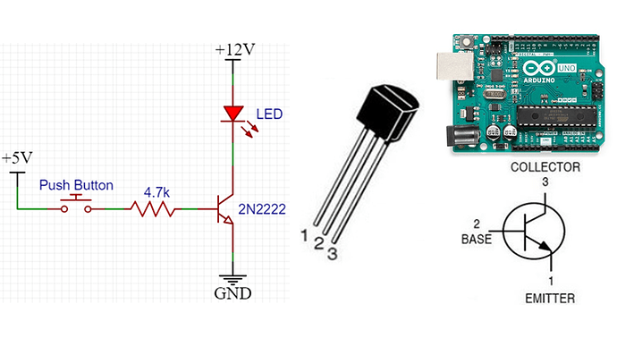

The simulation does not have "transistor" as a selection, but you should supply power to your LEDs starting from a power supply, through a transistor, to your LED, with the Arduino DIO pins controlling the conducting of the transistors.
You should draw your idea on paper (and post that here). It will convey you idea better. (because your text in both posts is confusing)
Give it a try.
Im making the diagram rn, hopefully it will be better than my explaining skills.
By the way, I couldnt understand what the transitor does. Does it just generate more power somehow? (I just started this stuff no longer than a month ago so I dont know anything)
Each transistor is the regulator and power handler to each LED. Like a faucet controlling water, you (using the Arduino) control the amount of power sent to the LED.
so Im goingto need one transitor per led.
what if I parallel circut the leds? will I need to put two transitors or just one
Yes, for individual LED control.
and I also need to code all of them seperatly right? Itsgonna take up so much so much space oof
Yes.
No more than your current code... same DIO pins... but power comes from an external supply, through the transistors... and as you learn to code, you will learn how to remove redundancy.

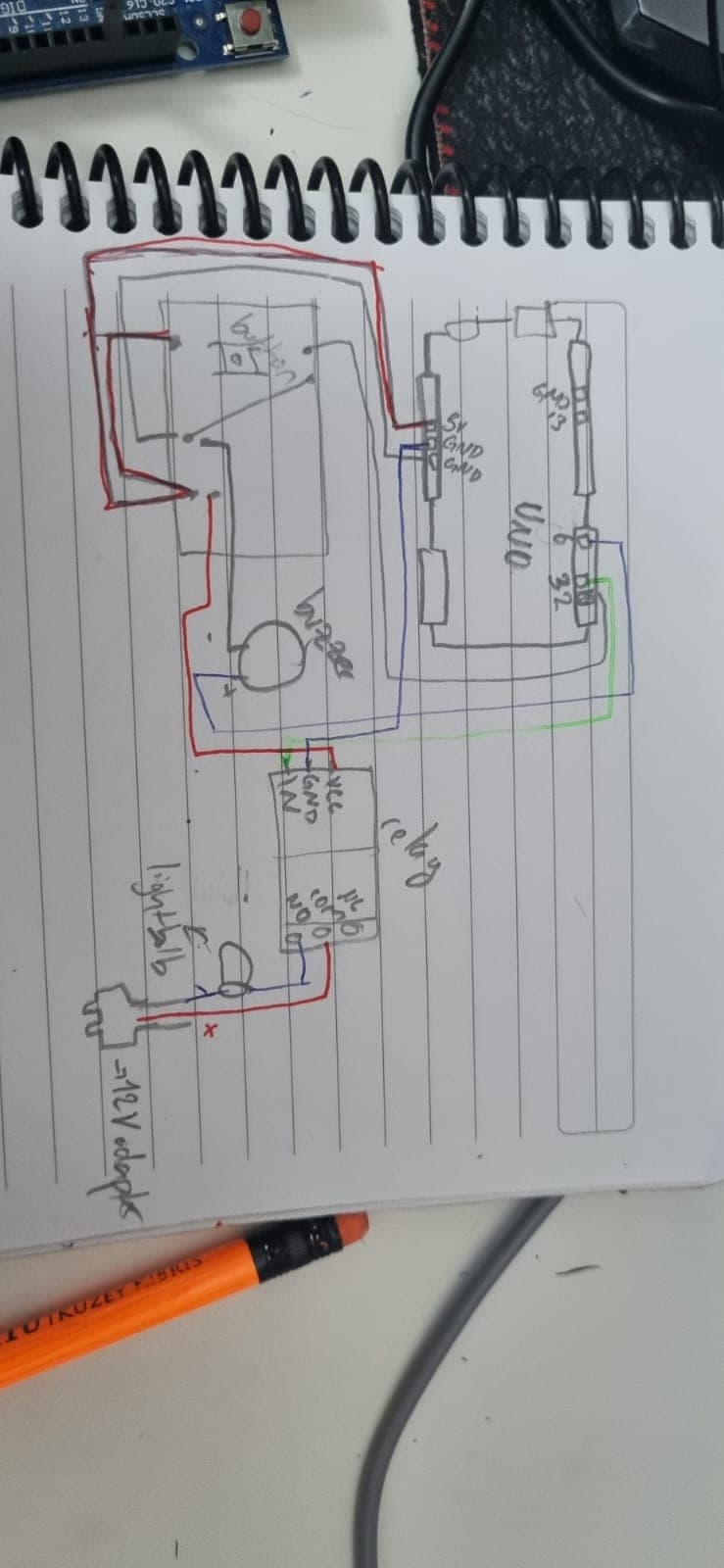

did my best to draw the diagram of the abomination I've made so far. I've been trying to find a way to connect the NC pin to the leds but cant find a way to do it and with what you've said, its only going to get more complicated I think but Ill manage to do it.
now that I think about it, just sending the picture of the circuit would be easier
The drawing indicates you are energizing the relay with the Arduino. That will eventually fail, probably damaging your Arduino.
can you tell me how to power it without relying on the arduino while using the minimum space possible
also I can send the pics of the circuit if it helps. I even took a video with the lightbulb powered on
