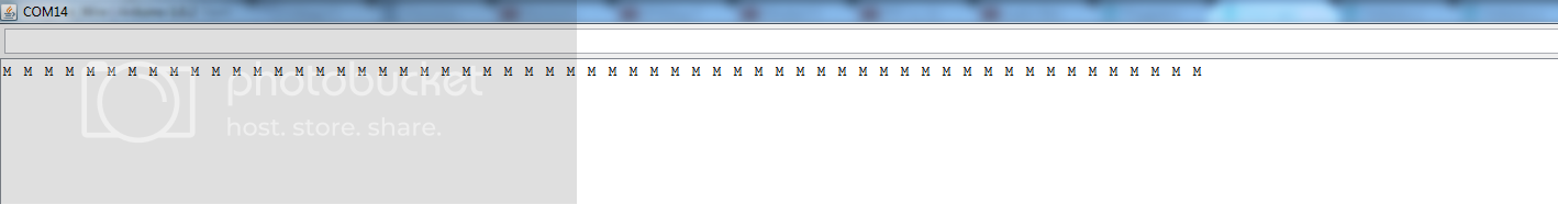

WHen I run the program on the Uno I get this...

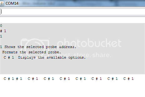

When I ran the code on two seperate arduino nanos i get this...
And here is how the output should look like as I coded it on the arduino Mega...
as you can see I get the exact same garbage text from the nanos and the uno which leads me to believe that the problem might be with the Atmega328P µController since that is what the nano and uno share in common and also do not have in common with the Mega.

If the code runs on a processor with 8K of SRAM but not on a processor with 2K of SRAM, then the most likely conclusion one can draw is that memory is being exhausted. The F() macro would help you immensely.
PaulS:
That actually sounds reasonable... It has no problem printing correctly when the function prints out 2 or three lines but with these big lines it seems to mess up... I will take a look in to the F() macro and get back to you

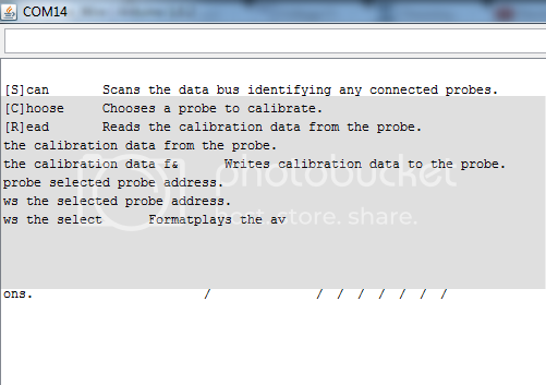

When i run this code...
void displayHelp()
  Serial.println();
  Serial.print(F("[S]can"));     Serial.print(F("      "));    Serial.println(F(" Scans the data bus identifying any connected probes."));
  Serial.print(F("[C]hoose"));   Serial.print(F("    "));      Serial.println(F(" Chooses a probe to calibrate."));
  Serial.print(F("[R]ead"));     Serial.print(F("      "));    Serial.println(F(" Reads the calibration data from the probe."));
  Serial.print("[W]rite");    Serial.print("     ");     Serial.println(" Writes calibration data to the probe.");
  Serial.print("[V]iew");     Serial.print("      ");    Serial.println(" Shows the selected probe address.");
  Serial.print("[F]ormat");   Serial.print("    ");      Serial.println(" Formats the selected probe.");
  Serial.print("[O]ptions");  Serial.print("   ");       Serial.println(" Displays the available options.");
  Serial.println();
I get this...
which is great and all but then when I try to add more F() macros it starts acting weird again (even with the first part that seemed to work fine after the macro). Then if I push it even further and add more F() macros the whole code just stops executing... I read that a way to debug if your running out of SRAM is to comment out big pieces of Serial.print() functions so I did and ran this code...

and this is what I got...
and it just keeps printing M infinately until I close the hyper terminal
So now I feel that I am back to square one and have no Idea what could be causing this... I am currently testing this on my Uno by the way since I have ruled out that the problem is with the actual arduino and decided that the problem lies within the actual µController and its characteristics.

Well I finally got it working... You were right from the begining Paul about the memory and F() macro... I just put F() around every Serial.print and got rid of a 512KB buffer and instead made it a recursive 32KB buffer and now everything runs as it should.
Lesson learned. Many thanks!
