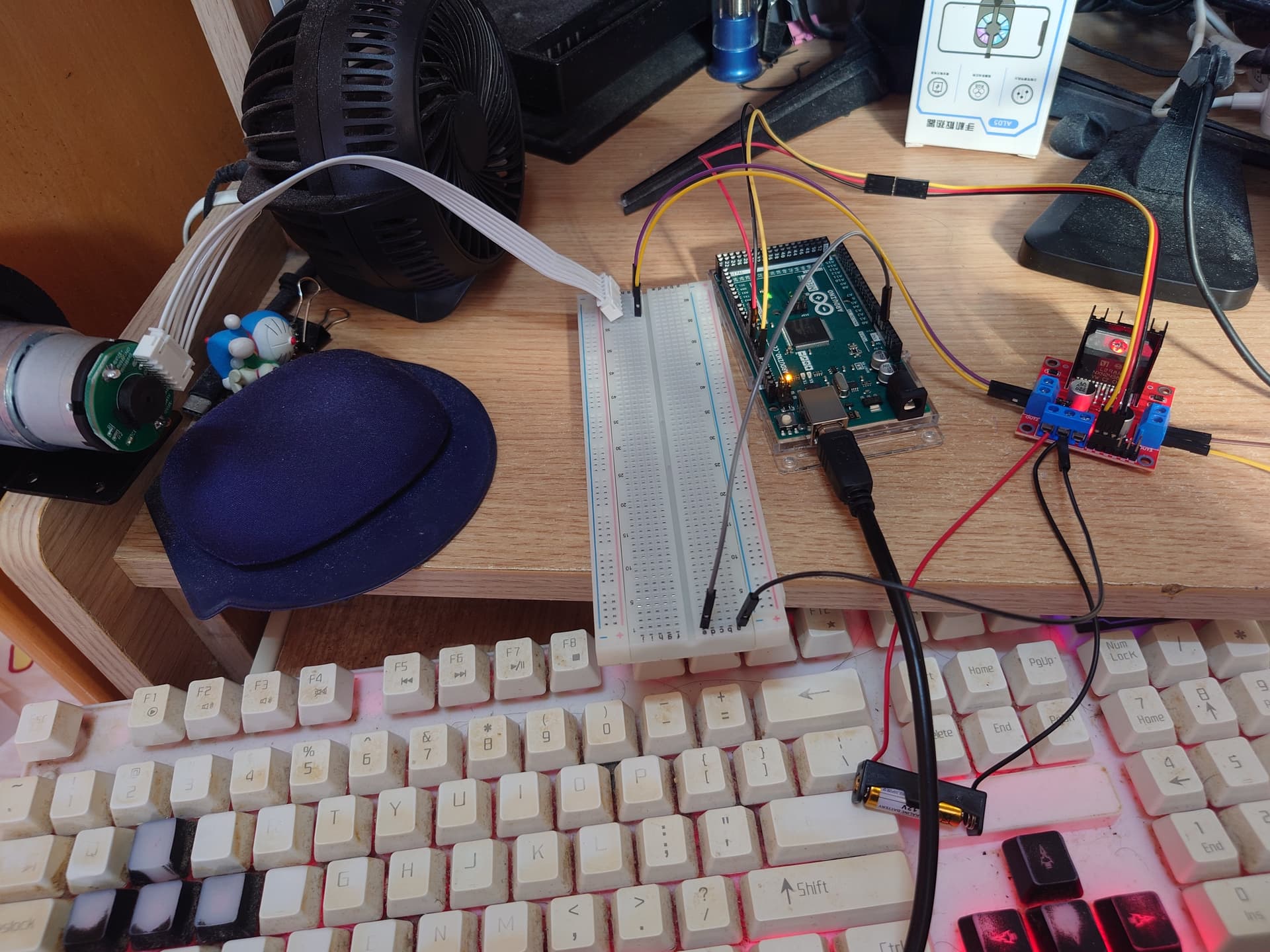

So basically I can't even get the Dc motor to run at all. I asked the manufacturer and they told me I need a PWM frequency of 10khz for it to work and my code did that I think. However nothing works. Can anyone tell me what's wrong with my circuit/code? Thanks in advance.

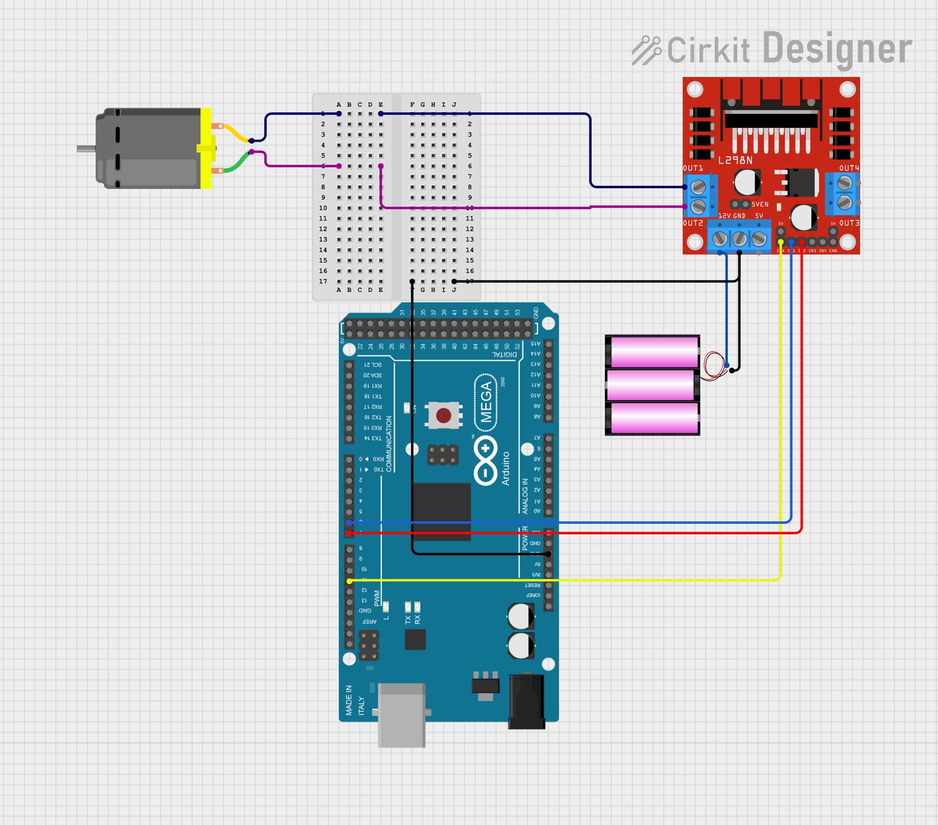

Can you knock out a schematic that clearly shows your connections and devices.

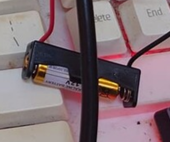

I'm looking right at that dinky little 12V battery. I'd be surprised if it has the amperage to run the motor controller, but there's no way it can supply the 540mA needed to run a single motor. It's just not going to happen.
You have not connected +5 V on the driver board. It is needed for the logic.
It looks like they've got the 5V enable jumper in, which, if I remember how those modules work correctly, means that it's using its onboard 5V regulator which is being supplied by the 12V battery. If you look carefully at the picture, you can just see the top of the jumper, and the glow of the LED which would indicate that the 5V supply is up and running.
This battery for that motor? LoL!
Your motor needs over 5A to start. I doubt that battery can supply 1/10th of that.
the battery package says it's a 12v23A battery so I thought it is enough
Can you post a link to that please.
Here Powercell Alkaline Batteries 23A 12V Pack of 20 Batteries A23 MN21 MN23 L1028 V23GA LRV08 8LR932 for Remote Control Gate Anti-Theft Bell Alarm: Amazon.de: Electronics & Photo
Bad news, I'm afraid. "23A" is a code for the physical size of a battery, not it's maximum current output.
You're gonna need a bigger battery...
Damn... okay I am gonna buy a bigger battery, thanks for answering
