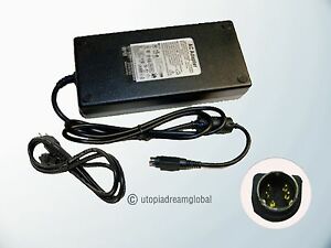

I'm recycling this old power adapter I found lying on my house to power the Uno thru its Vin pin with its 12V pin and also to power a 12V water pump.

The problem appears when i power it with the 12v, im planning to use the 5v pin the power supply has instead of the 5v pin of the arduino, in case im drawing too much current and the arduino cant handle it.
OK. The power supply connector looks odd with 5 pins. What are these all for ?

Sorry im abroad and cant draw the schematic. The connector has one 12V pin, two GND and two 5v.

This looks like a specification of your power supply.
Have you also tried powering the Uno through the 5 volt output of your dual volt power supply ? Use the pin marked 5V on the Uno.
