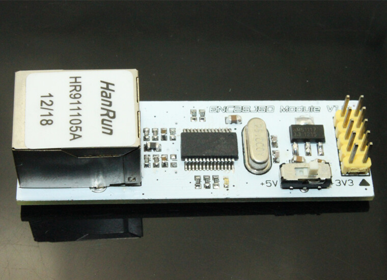

Hi guys, I am having trouble, hoping someone here can shed some light.
I have several different types of ethernet modules that I cant get to work with ANY of my arduinos.
they are all ENC28J60 Based modules, I have attached pictures of the three kinds I have.
I can get this to work just fine when using an ethernet shield, but when I substitute any of my ENC28J60 based modules, nothing at all. the link light comes on, but nothing else.
I am using this code to momentarily push a button on a garage door opener to allow wifi control over the garage door.
This is the module I have connected atm, it is not working, but I want it to work.http://www.elecfreaks.com/store/enc28j60-mini-ethernet-module-33v5v-p-449.html
Can someone help me out?

You must use an ethernet library for the ENC28J60. The standard ethernet library included with the IDE is for the Wiznet w5100 module.
I have tried that. Could you show me? Show me a sample sketch?
what would REALLY help me, is if someone could post a link to a KNOWN WORKING library for the ENC28J60 and a pin for pin schematic, as I am not even positive that I am wiring it correctly being that it is not a snap on shield but rather a separate daughter board.
Also, a simple sketch so I can confirm my enc28j60 is working, and then I should be able to do my projects.
I posted pictures of the three kinds of enc28j60 modules I have already, so if anyone has one of these working in their project, I would really appreciate a hand here.
Thanks so much in advance, I appreciate your time.
