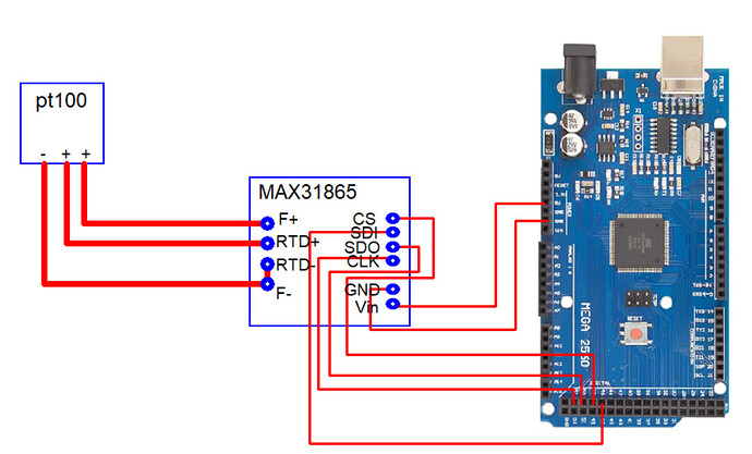

I'm encountering a problem with my setup using a MAX31865 RTD sensor on an Arduino Mega 2560 with an Ethernet Shield (W5100).

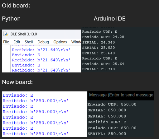

Previously, on older Arduino Mega boards, I was able to use hardware SPI for the MAX31865 and the Ethernet Shield without issues. However, on the new Arduino Mega 2560 boards I've purchased recently, the hardware SPI communication with the MAX31865 stops working.
When I switch to using software SPI, the MAX31865 operates correctly. But as soon as I call Ethernet.begin(mac, ip);
to initialize the Ethernet Shield, the MAX31865 stops functioning.
Another unusual detail I noticed is that software SPI communication fails if the sensor’s SDI pin is connected to digital pin 51. When SDI is connected to any other pin, it works as expected.
I have double-checked the hardware connections (even swapping SDI and SDO on the MAX31865) but the problem persists.
Has anyone encountered a similar issue or found a solution to restore reliable hardware SPI communication on the new boards? Any help would be appreciated.
