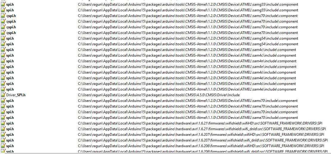

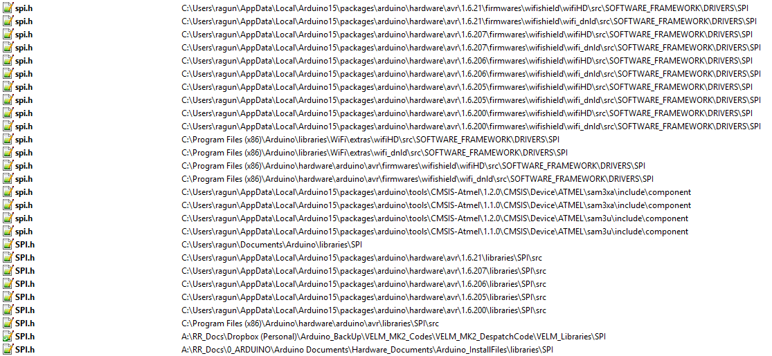

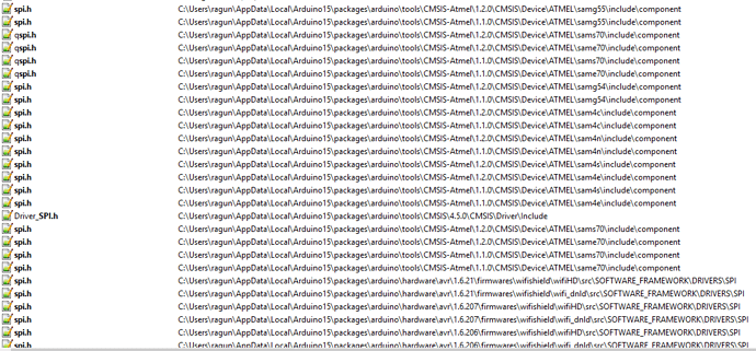

Well i did a search for SPI.h to see in how many places it was there. To be honest i am zapped. Its almost two screenful of locations. Just see the screen shot attachments. Is this kind of normal or i have a very messed up IDE installation ?
Ardubit:
But only three locations actually matter and the Arduino IDE already told you about them:
