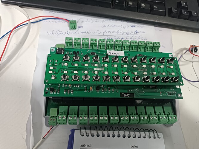

Hi im trying to solve a bug in a home automation device. The device works as follows : we touch a button on a touch panel or smart phone which is connected to some key via wifi and that key is connected to a device and some relays are activated this way. The problem is when i touch buttons on touch panel quickly sometimes the data is not received by esp32 I send and receive data on RS485 using esp32 with arduino platform and free rtos. I tried to use different cores for transmit and receive but this bug still occures. what is the reason ? What should i do to solve this bug ? Here is the transmit task I will post the receive task i the follow up posts. thanks in advance.

Here are some photos of the device and touch panel so you could have a better understanding of the device
Are you sure it is actually being sent ?
Yes
And have you put a terminator on the RS485 ?
Yes
