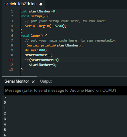

I do not know if this is problem with upload of script or something else. I wrote easy script that counts to 10 then starts over.
int startNumber=0;
Serial.println(startNumber);
startNumber++;
if(startNumber>9)
startNumber=0;
I am using arduino nano v3.0 with new bootloader. When i upload script rx led lights up but after i finish uploading only pwr led is lit.I can not see anything on serial monitor
Does anyone know what is the problem?

Your sketch works for me, noting that it actually prints from 0 to 9, not 0 to 10
All I changed was the baud rate to match my standard rate. What baud rate is the Serial monitor set to on your system ?
Please turn on verbose output for compile and uploading in the IDE Preferences dialogue, upload the code and post the full output from the bottom window of the IDE, using code tags when you do

My baud rate is set to 9600 in Serial monitor.

Please enable Verify after upload in file → preferences .
Original or clone?

I am pretty sure it is clone.

This is error when i enable code verification.
Hi @ch0da . When the "Verify code after upload " preference is enabled, after finishing an upload Arduino IDE reads the memory on the Arduino board and compares the read data against the data of the compiled sketch binary file on your computer that was uploaded to the board. When it did that, it found that the data on the Arduino board did not match what should have been there. This means the uploaded program was not written to the memory in the Arduino board during the upload process as expected.
It is possible that a short or external circuitry connected to the Arduino board could cause this type of problem by interfering with the upload process.
Make sure the board is not sitting on anything conductive that could short the contacts on the bottom of the board. Make sure there isn't any conductive debris (e.g., strands of wire or component leads) on the board or on the surface the board is sitting on.
If you have another USB cable on hand, try changing the cable. Maybe a damaged or defective USB cable could be the cause. Make sure the USB cable is fully inserted into the USB socket on the board and computer.
If you have a shield or any external circuitry or components connected to your Arduino board, try this experiment:

I tried plugin arduino by itself nothing connected to it except USB cable.I am not noticing any short circuit or bent pins on arduino. It is standing on my wooden desk so it should not have any conductive elements near it. Only thing i notice is that arduino gets hot when plugged in , I think this is normal but can not be sure this is ,y first time working with arduino.
I tried 3 cables that i know work. They all produce same error.
It is not normal. Unfortunately, the problem is probably caused by the Arduino board having suffered permanent physical damage. I recommend you carefully review what you were doing with the board the last time it was in a working state. You may be able to identify the cause of the damage and in this way profit from the mishap by gaining knowledge that will allow you to avoid subjecting boards to the same conditions in the future.
Unless you have the right tools on hand and the skills to use those tools, repair of the board will not be feasible. I suggest you attach a note to the damaged board describing what is wrong with it and put it in your electronics salvage bin. Then purchase a replacement board.

Thanks for information. I got it from store like 2 days ago and just wanted to test this program for writing numbers to screen while I wait for screen to arrive. I am guessing I got sold bad copy. I would like to support you guys but originals are not available in my country only clones and clones that are posing as original. Thanks for help.
