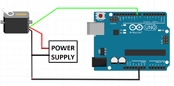

i am building an egg incubator
i am encountering a problem when:
When the servo motor is on i do not get readings from my dht22 temp & hum sensor.
Once the servo stops i get readings normaly.
I browsed in here for a bit and found out that i need a separate power supply for the servo, most people suggest a 4x AA battery holder while others say that this is more than enough and it will burn the servo. So my question is is it safe to use the 4x AA battery holder?
Below is my code (i have all the parts finished but i add little by little t my main code and test)

Always show us a good schematic of your proposed circuit.
Show us a good image of your ‘actual’ wiring.
Give links to components.
Using delay( ) in your sketches is almost never satisfactory.
A non blocking delay using the millis( ) function is what you should be using.
Four AA batteries is 4 * 1.5v = 6 volts, most servos work with 4.8V to 6V.

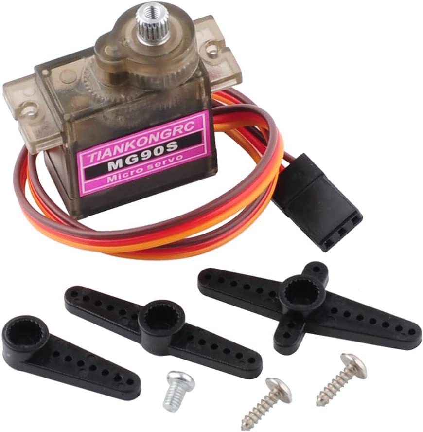

here is the servo i am using
Four AA batteries will work.
Yes, that is a very popular power supply for a servo if the servo is rated for 6V. Typical servos are rated 4.8V to 6V or 4.8V to 7.2V. Consult the data sheet for your servo to confirm.
thank you do i just conect the vcc and ground directly to the battery holder or is the wireing more complex. Will four batteries be enough to get me through the 21 days required to hatch the chicken eggs?
If you used a 5V cellphone charger for the servo, you could connect the charger directly to the servo; the servo would then be constantly powered.
Connecting batteries permanently will eventually kill the batteries.
Battery operation for permanent operation might include a way of turning the servo power off when the servo is not needed.
Remember, batteries will eventually die :frowning:
It’s a guess, but since you are heating the unit, then you must have AC power available, if so, suggest you use a 5v cellphone charger etc.
Connect battery power source ground to Arduino ground and servo ground.

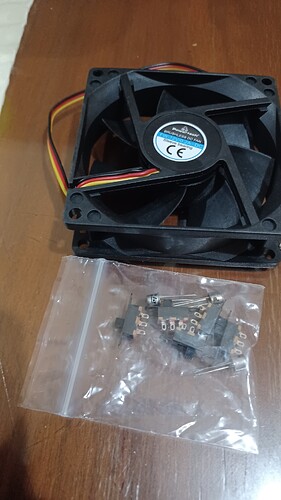

Also i will add 1 pc fan to spread the heat l.
Will i encounter the same problems with the servo? Should i have 3 celllphone chargers?
( 1 for the arduino 1 for the seevo and 1 for the pc fan)
If the fan is 5v the same 5v power supply can be used for all 3 components.
  • Do you have any transistors ?
  • What fan are you using ?
  • What Arduino do you have ?
I do have transistors an am using arduino uno r3

It is a picture that shows the fan and the transistors
Your fan is 12v @ 200mA.
If you insist on using this fan, you will need a 12v and 5v power supply.
  • What transistors do you have ?
  • Show us your proposed schematic?
  • Why have you undertaken this project ?
I do not know the things in the picture were given to me by a friend. I took this project because last year my peahen laid eggs but stoped incubating the eggs once the first one hatched and aperantly its the way with all peahens. But just to be safe i will first try using the machine with chicken eggs and then ajust it to take peacock eggs
You will need a 12v and 5v power supply.
  • How will you control the heating element ?
That servo is not the best of quality for this project.
Metal gear servos would be better.
Show us how you will connect the servo to the mechanism.
I found out that the transistor is a BC108
I will heat the eggs by using a heating lamp that will be connected to the arduino via relay and there will be a cable that will connect the relay to a wall outlet
