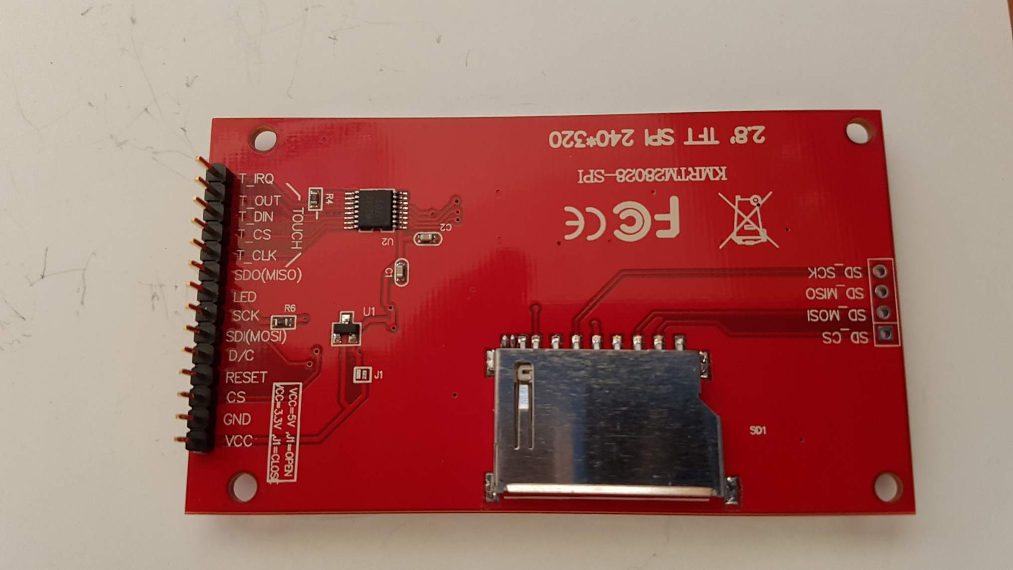

I ordered the display from eBay in this Link.
And I received the display in pictures 1-3.

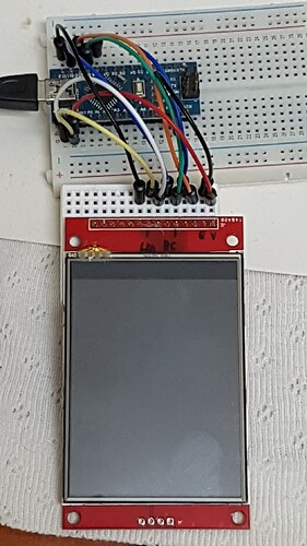

I connected the display as pictur 4, with nano.

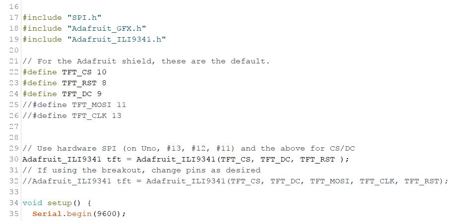

The connections as recommended in the example graphicstest.ino, Figure 5.
I used all the possible libraries I found on Google, according to Figure 6.

Despite the description stating it handles 5v logic I see no level translator so I think the advert is wrong (this is often the case).
You will need logic level converters, one cheap method is to use resistors. as mentioned in the instructable:
Stick with the library you have and get the display going before you try others.

Adafruit examples omit the RST argument in the constructor. Add the RST argument and everything will work.
If you are too stubborn to use the correct constructor, you must add a 3.3V pullup on the RST line.

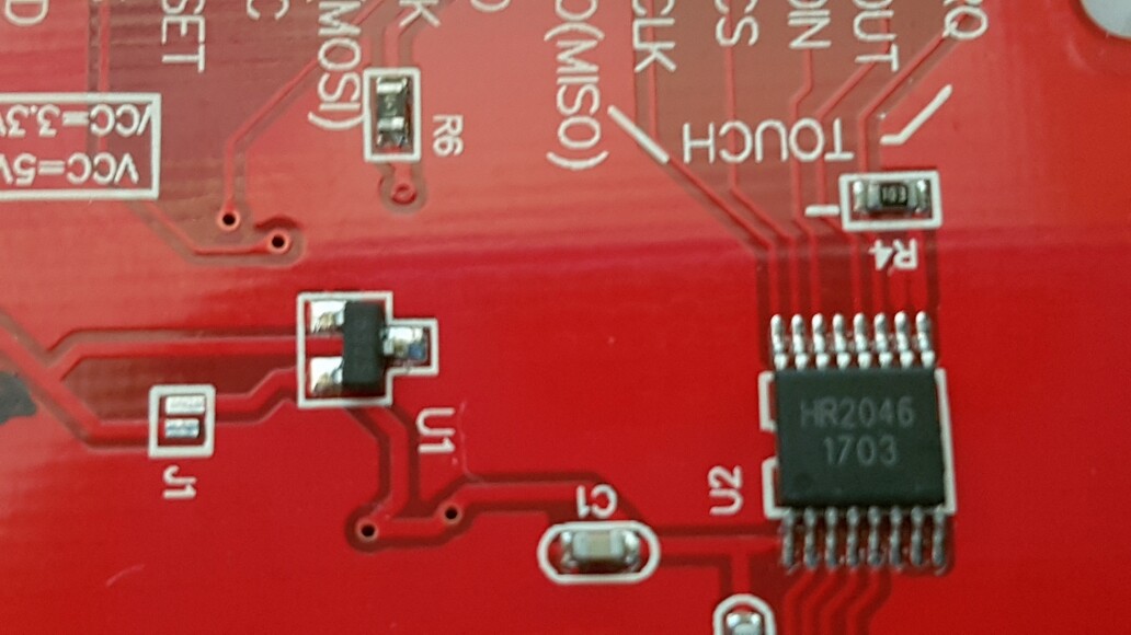

The description of the item says that it is possible to connect 5 or 3.3 volts, which did not help.
I begin to fear that I have knocked the display.

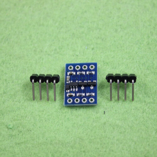

I ordered this Level converters,
And I hope that these will help, I wait and see.

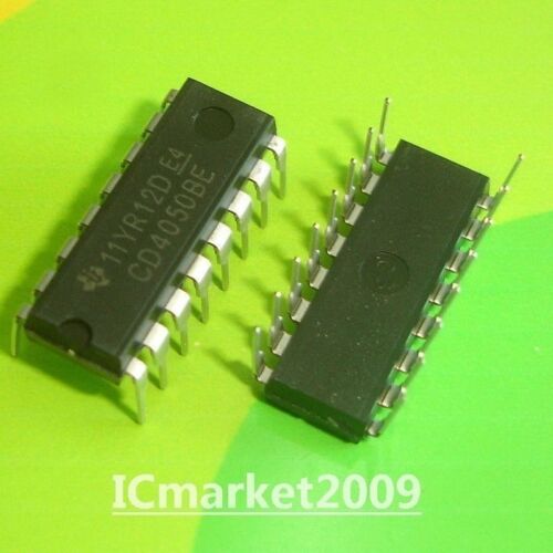

CD4050BE it's the best choice
You need at least 6 channels for shifting SCK, MOSI, TFT_RST, TFT_CS, SD_CS, T_CS if you want to use TFT, SD, XPT2046.
MISO will be at 3,3V levels anyway. I would use a small series resistor in the MISO line and T_IRQ line.
The CD4050 has got 6 channels in one chip. Other buffer chips are available.
5pcs IIC I2C Level Conversion Module 5-3v System For Arduino Sensor | eBay
if you only want to send data to the screen , a simple resistors divider would do to conver 5v to 3v :slight_smile:
you only need fancy converters for read outs

If your display is not working with TFT_eSPI library examples, I suspect you have damaged it.
Buy another display.
