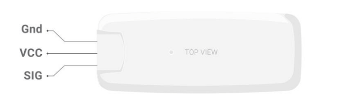

Hello everyone!
I use an EMG sensor from Elemyo. Everything works correctly on Arduino MEGA, the ELEMYO library is connected, filtering too.
But when connected to ESP32 (powered by 5 V, signal on GPIO 33, 32) and using the same library - the microcontroller infinitely reboots
I tried different pins and turned off filtering - the effect is the same.
Or do I need another way of filtering?
I will be very grateful for your help
