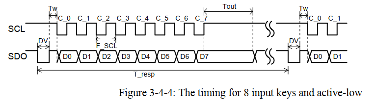

hi I'm trying to use a 16 channel capacitive touch sensor named ttp229BSF with Arduino uno. i use the following code that doesn't work. when i touch the keys it detects the keys but also prints out some wrong keys before detecting the touched key . i linked the required jumper as shown in the attached pic . here is my code. what is the problem here? is there a better and more robust way to do this based on the timing diagram on the datasheet that i attached ?

Failing to provide the TTP229 datasheet and failing to comprehend what an I²C interface is.
It appears you also do not understand the alternate reading mode which is similar to I²C in a very "stripped-down" version, as your code simply fails to implement it, thus the random data.
The timing chart you cite is not in the datasheet I found. Best give us the Web link to the information you are attempting to follow. :grin:

OK, so there are two different version s of the TTP229; the "BSF" which appears to be the one @salar1991 has, and the "LSF" which has an actual I²C interface.
The "simplified" interface of the "BSF" nevertheless requires a protocol which in some ways resembles I²C; you need to synchronise the serial stream by asserting a pulse on the "SDO" line, then clock out the bits with the "SCL" line whilst reading the "SDO" line (which means it must variously be an output and then an input).
That is what your code needs to do.
So the question remains, from where are you getting the supposed information on how to do this? (Mike or) I could probably figure out how to do it (I have ordered a board; will arrive in three weeks or so) but if you have an actual reference it may be a good start. :grin:
@Paul_B i changed the code as you said the correct number is printed out but its repeating for ever when i press the key one time
